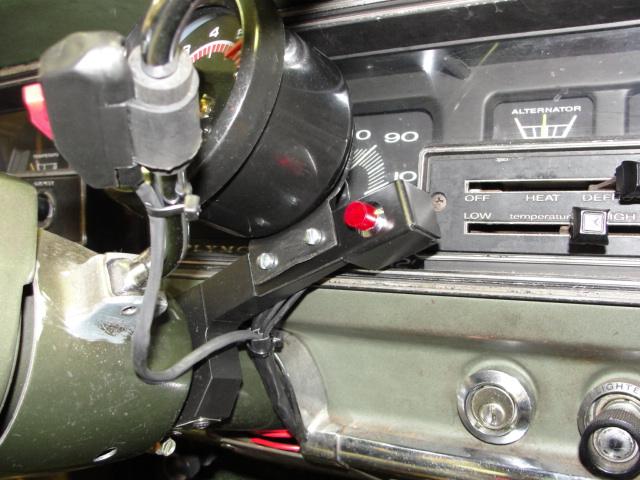

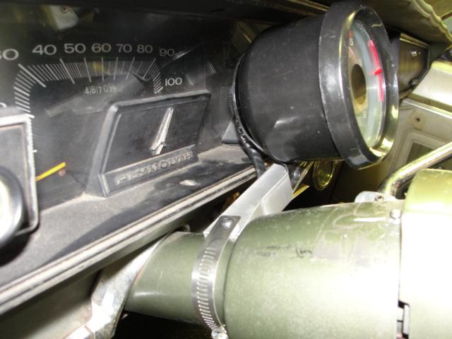

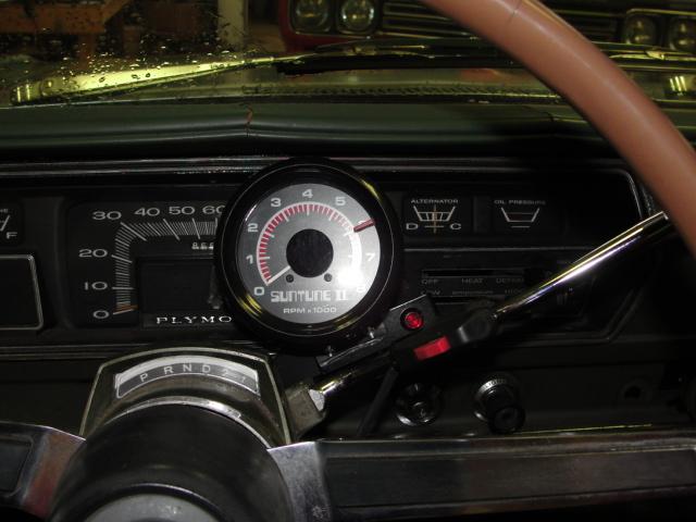

Here's what I did. Maybe hard to see but I grabbed a piece of aluminum and with the help of my Bridgeport I widdled out this mounting bracket. I cut a hose clamp and screwed the ends to the block and painted it black. Later I folded up another piece of aluminum to mount my line lock light.
