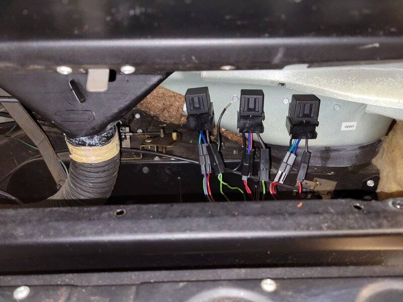

Thanks for the info, removed the glove box today and there is nothing that resembles the sardine can. I've been back there before because I updated my headlight relays about 5 years ago. Next I'll trace wiring from the tach.
