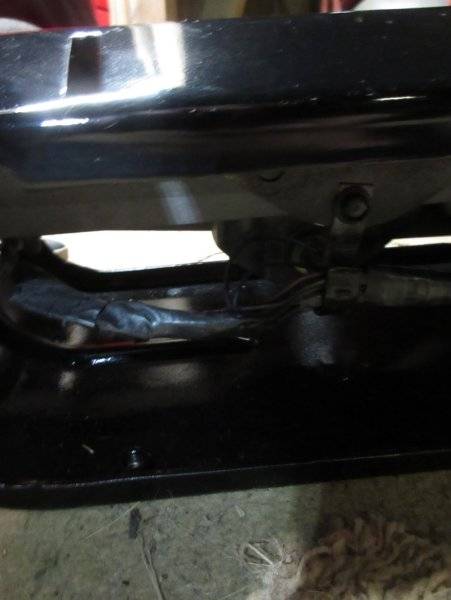

I've got two more brackets like the one in the middle/right of this picture. Where do they go? Extra points if you can turn up a pic of the bracket that holds up the fuel filler tube.
Edit - O.K., the filler tube bracket goes on the back of the car, and it looks like the other two go under the bolts for the center trim piece, and support the harness where it arches up over the fuel filler neck.
