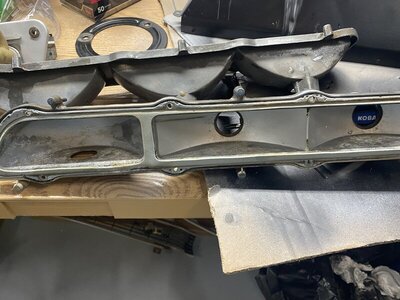

Working on the taillights, housings, and trim bezels on my 1969 Dodge Super Bee. Several Questions:
1) What color silverish paint(s) should be used on the plastic part and then inside the housing where the bulbs go?
2) What treatment, if any etc on the bulb housing to make them look factory original?

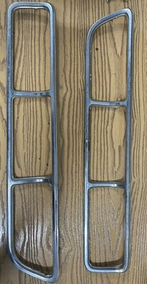

3) Need to re-chrome or similar the bezels. I've gotten prices of $400 to $450 each to re-chrome, wow!, and $150 each to do something similar but not actual chrome. Any suggestions? These have to look nice.

My OE housing finish, never restored...
..there's no texture to them, just a light mist of silver/argent that is a fairly consistent colour. Definitely lighter than the argent on the front grill...

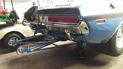

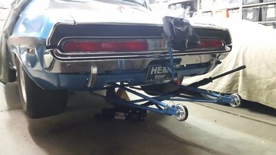

I used a dull metallic silver like argent wheel paint when I restored the tail lights and side marker lights on my Challenger.

The pot metal housing exterior on my cars were not painted but had a factory cast finish that was filthy. I cleaned them with Eagle 1 Mag Wheel Cleaner Etch. Worked great, nice original finish look.

Any suggestions on these taillight bezels? Re chroming at $400 each seems high, but I may have no option...

Thanks! I'm gonna try both the mag wheel finish (mine are filthy also) and the plastic polish you recommend.
Just use an old tooth brush when applying the Mag Cleaner, leave it on for about 5 - 10 min, keep an eye on it and wash it off. If they are filthy, clean the dirt off as best you can. When I cleaned mine they still were dirty looking and that's what the Mag cleaner will take care of and leave a nice cast original look.
I'm making the decision to re chrome the top plates for the console in one of my Chargers. I'm just going to suck it up. I might do the same for the taillight bezels.
