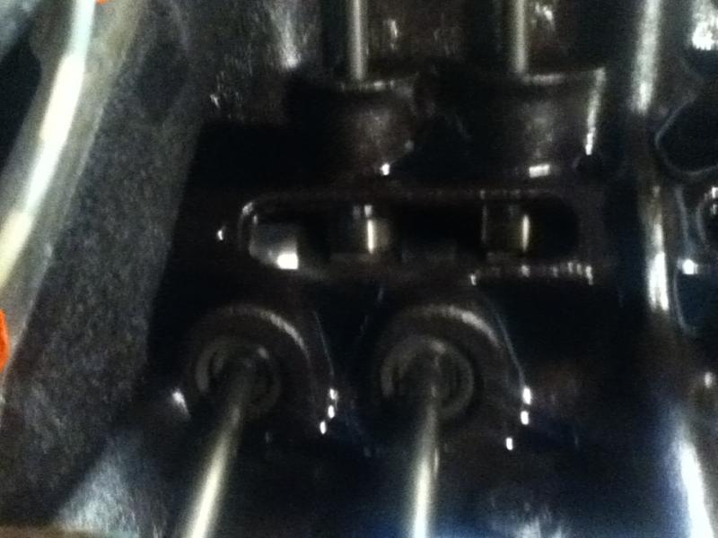

Ok. So I've removed the rocker arms and shaft from the pass side of the engine. The first thing I notice is the one push rod (where I could move the rocker arm by hand slightly) was out of place. In other words the bottom end of the rod was not sitting directly down into the lift plunger..it was off center, sort of sitting on the left side lip of the lifter. I don't think it could have moved into that position, by accident while I was removing the shaft. I also pulled both push rods (for intake & exhaust). I ran both across and absolutely flat glass table top. Both rods were completely flat and rolled easily on their own across the surface with little effort.
Visually I can't see anything wrong with the suspect lifter. Here's a pic....its the lifter on the right. Its been my experience that no problems is this easy to fix..meaning I don't think the rod just "popped" out of place. However, I would rather not go in and distrub anything if there is nothing wrong either.
I dunno, whadday think? Any eagle eye see something I missing with that lifter? Should I pull them all out now that I'm in there anyways? I'd hate to do that if this is just a stupid little problem. Everything else looks fine to me.

Pull the lifter out of the bore and take a high resolution picture of hit and the cam lobe....
I know this may be a stupid question but here it is anyways....if I pull one lifter out, and there's nothing wrong with it, can it go back in? I mean I KNOW it can go back in, but do I want to disturb it when I can see the plunger is not damaged? Last time I replaced them I could clearly see that the noisy lifter was collapsed..the plunger was crushed down.
