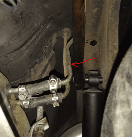

In the six years I've had the Coronet (68), I've always smelled gas when I come home from a ride. I found out why yesterday... the vent tube will puke fuel when I come to a stop. She has an aftermarket tank, and I'm not sure the fuel vent was run properly. The one vent tube goes up into the trunk of course, but the other runs up to the trunk pan and just hooks back down - right behind the shock mount (you can see where the mount is soaked).
Where should this line actually go? I checked the shop manual, but it wasn't really clear.

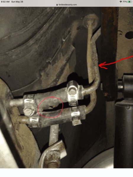

Is this hose damaged?
Yeah, I spotted that this morning. I knew some one would see that - LOL. I just replaced the hose on the actual fuel line, and then saw that one. It's not leaking though. But have you guys experienced what Wayne was talking about? And where is that line supposed to go...back to the filler neck, or right where it is?

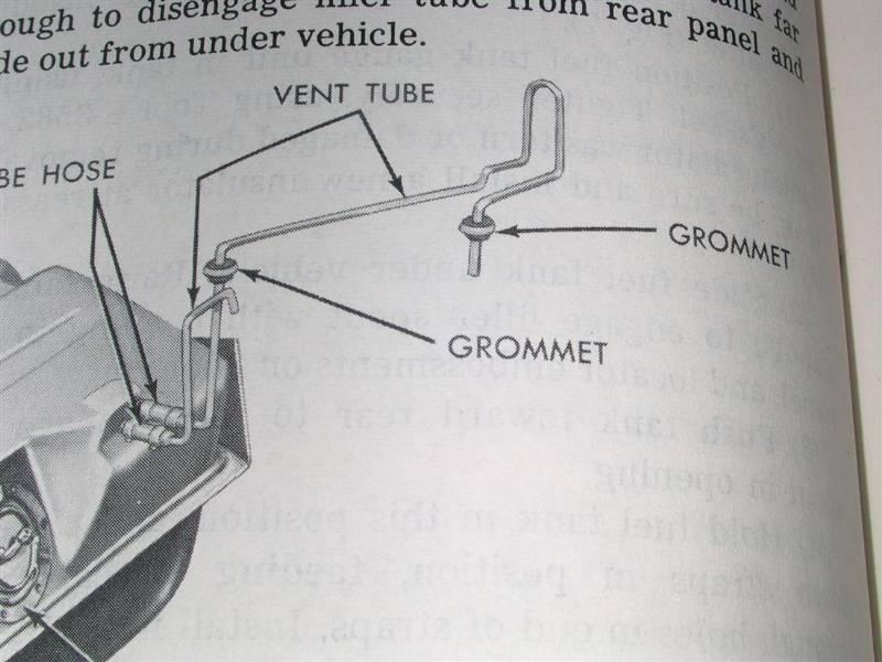

coronet vent ends up over the pass side shock tower,revers lines to see if vent lines are backwards.

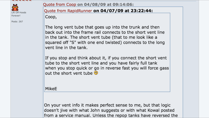

Long line to short line! Meaning the short shock tower line should be hooked to the long line in the tank that goes right back to the filler neck area. The long line up into the trunk should hook to the short line in the tank.
Both lines coming out of the tank are the same length. Also, there is no line going toward the fill neck. Mine is like Dave's picture shows.
Go find my restoration thread that shows actually pictures of of inside a tank. I'm not talking about the length the tube sticks out of the tank. On one of them the tube is ran inside the tank right back to the filler area.
It will all make sense when you look at the two different tubes inside the trunk, and realise that there is a short tube and a long tube inside the tank.
These different lengths allow for parking on an incline - either facing down or up a hill.

Is this what is going on?
Exactly. And if the fuel is high enough (full enough tank) then it slosh around and give a similar effect in your garage.
