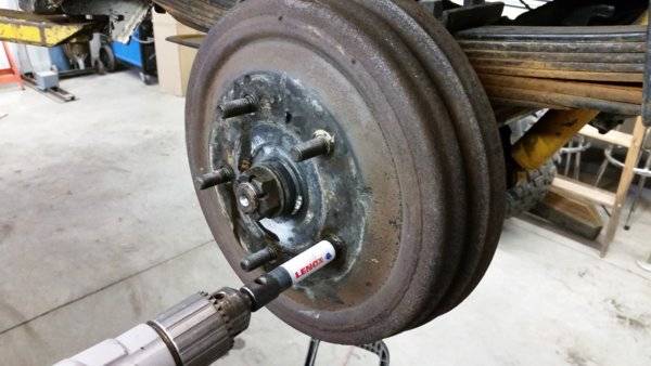

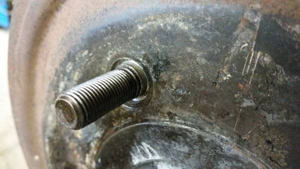

I just did my Jeep gladiator. Use a 11/16" hole saw with the drill bit removed. Cut through the swedge on the drum about .060" deep. Drum will come off. Yes the holes are larger. Clamp load of the wheel is what holds it all together anyway. if it really bothers you redrill the drums in a different area. Alternately Green style bearings with the proper length axle shafts will bolt right in. You must use Green style bearings as there is no room for an axle seal in the old style housing. It's not deep enough in the bearing area.
Doug
