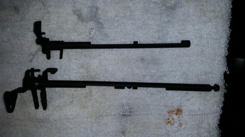

So I got my carb and parts back today from getting coated, really impressed with it, its gonna look awesome! Anyway, here are the throttle rods coated.

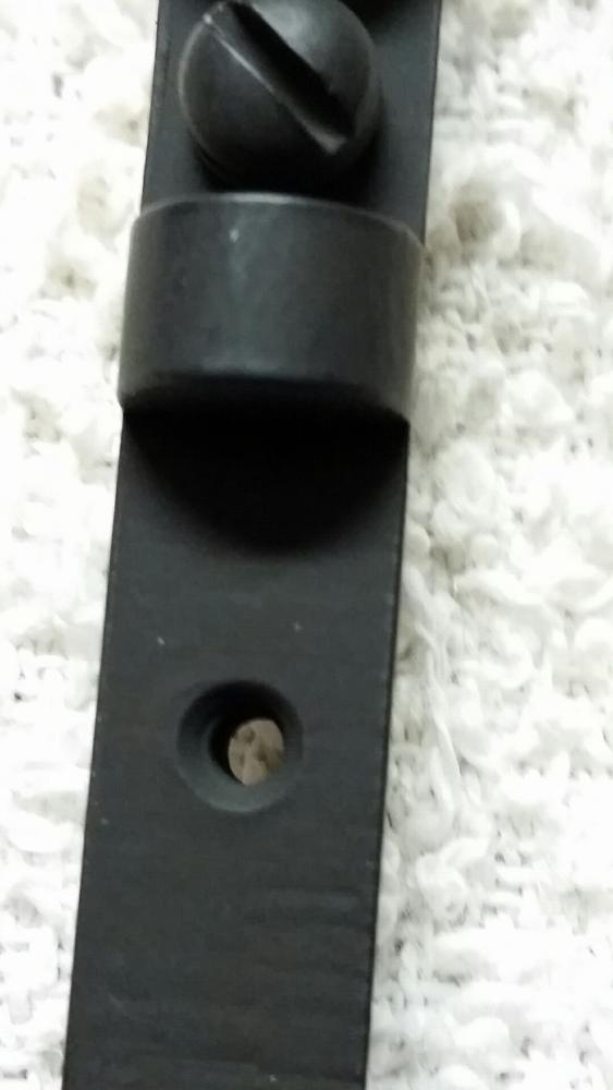

here is a close up to better show how thin the coating is.
