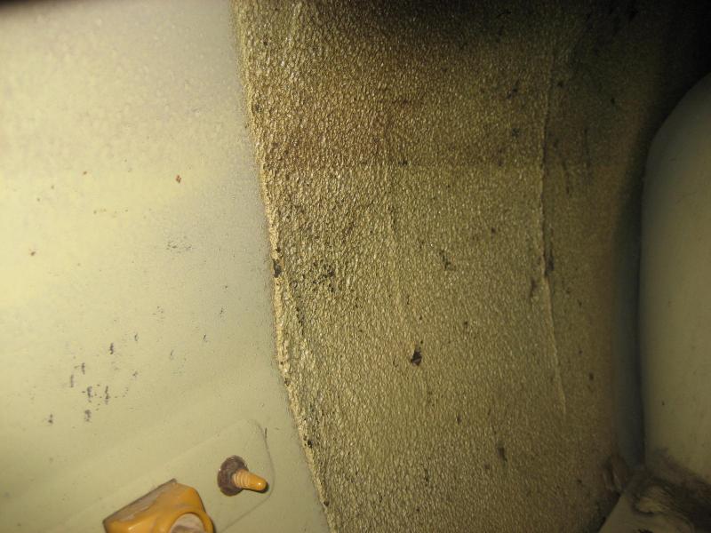

005.jpg Is this how it's supposed to look
we used bedliner. It looks very close. I'll try to get some shots posted at some point.
