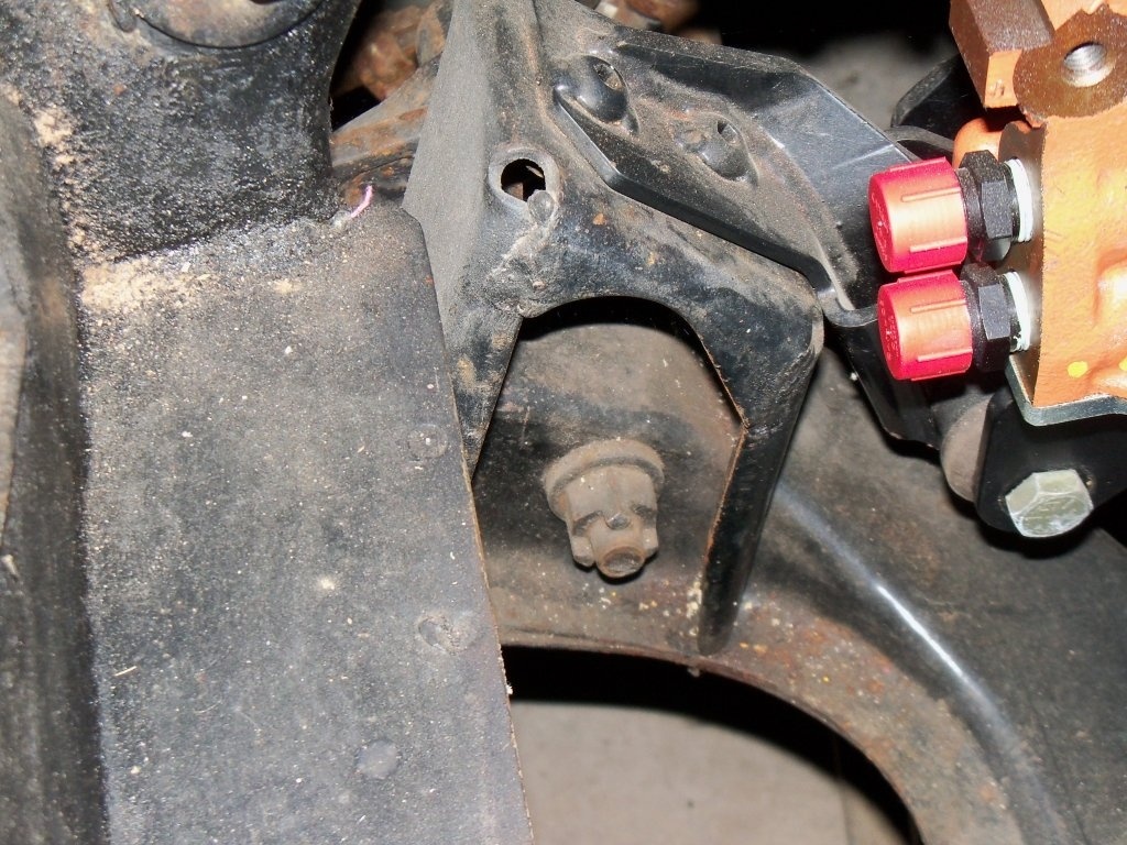

went to install my 5.7l in my 64 dodge. Had a new transmission mount to fit my transmission. I could not get the cross member to line up. Transmission case was hitting the fire wall. Transmission is a small block 727. Help, motor mounts from tti, transmission mount is a Schumacher for later model trans, not a 64 model. Checked mount positions measurements line up for the front of the motor.

Can you post some pics of the engine mounts and trans mount? It would help us to figure it out.
How about the drivers side and trans. Also need to see the back of the engine/trans together.

I wanted to put the engine and trans in as a unit. Its only me doing this. What can go wrong will. My jack decided to quit working. Anyway got the trans in, then put the motor and connected to trans. Now getting the mounts in their correct position, so the headers will fit. Hoping this week I can leave it in for good. As we know a 904 or a 727 will fit the tunnel.
That's good to hear ya got them in. Post some pics for us!
