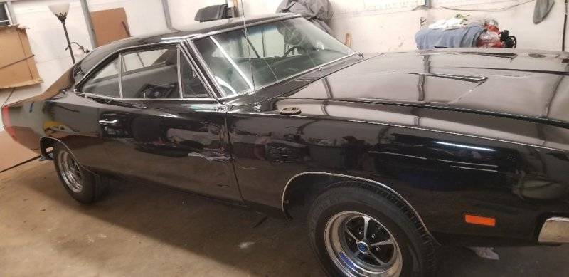

I have a black 1969 dodge charger I have been restoring. I bought if from a guy who had it 16 years. it was painted but gutted with a new rebuilt 440 , running gear not installed . I have put the interior in and it now is a running driving car been a lot of work still have more to do. I hope you can help me out. I have all lights working except blinkers. They were working but quit flashers , dimmer switch good , all exterior lights working, emergency flashers working, fuses good, power to both flashers, but blinkers quit working. Anyone ever had this problem and has a fix woud be great.

Welcome from NW CT. Bonus points for a photo on your first post. Show us more man...

Thanks for posting a pic of your beauty!
Always check grounds......
Look at the wiring to the turn signal switch. Sounds like a bad connection. Also check the ground wire to the column at the column support. Car looks great.

Sounds as though something is wrong in the column with the directional switch.
If you've checked everything else you will need to pull the steering wheel.

Welcome from the show me state!! Nice car!! If everything else works, I would start with the steering column.
