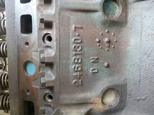

A 0.060" overbore is fine in an old block, and a newer block. If you sonic check it, you can map the core shift. If you weren't aware, the casting#-XX, XX represents the amount of times the cores were replaced. So, supposedly, the higher the number (XX), the larger chance of core shift. My understanding is no number = 0, and goes up to 10. Obviously, the more meat in the walls, the better it will handle heat.
So you're saying the -7 on the end of the casting number in this picture means the cores were replaced 7 times. Interesting. I hadn't heard that before. Thanks!
