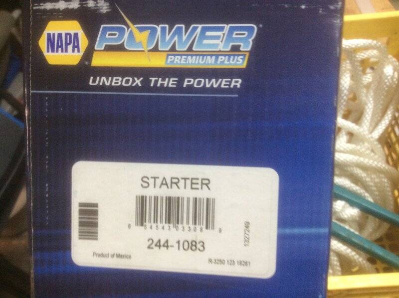

496" using Dakota starter. TTI 2-1/8 stepped headers ceramic coated but no heat shield. Summer temps are 120+. No issues after 2 summers with it.
I am super grateful for your suggestions. I will try to wrap the header tube closest to the starter, and check the starter relay. If this new starter fails again, I will look into the Napa brand Dakota starter. I am going to Lebanon Valley this Saturday, if everything works out and the weather cooperates. I will let you know how things work out! Again, God bless you for your assistance!

I went to Lebanon Valley in NY and met the nicest group of people on the planet. No Drama! They treated me as though we were family, as if I knew them all my life. They helped me and coached me through the whole day. I did not run well, but they made my day. Yes, the brand new starter broke when I was the next car to go down the track (it would have been my 3rd run). Now I am going to buy the Napa starter to see if that will work. I put in a o gauge ground wire from my battery in the trunk to the block. It looks like I will need to put in a couple more grounds. I have two expensive Power Master starters, that don't work. I am going to send both of them back! I will let you know if the Napa starter works? I don't know if it will turn the 13.5/1 CR engine, but I am pretty frustrated right now with this PM starter Co. Thanks again for the replies and information!
BTW my 440 Source starter seems to work well. Can't say about the reliability though. The fit is slightly better on my 440 block/727.
Jumping on this thread a little late. Does the starter in this picture work for 383s with 4 speed manual? Or do I need to find something else?
