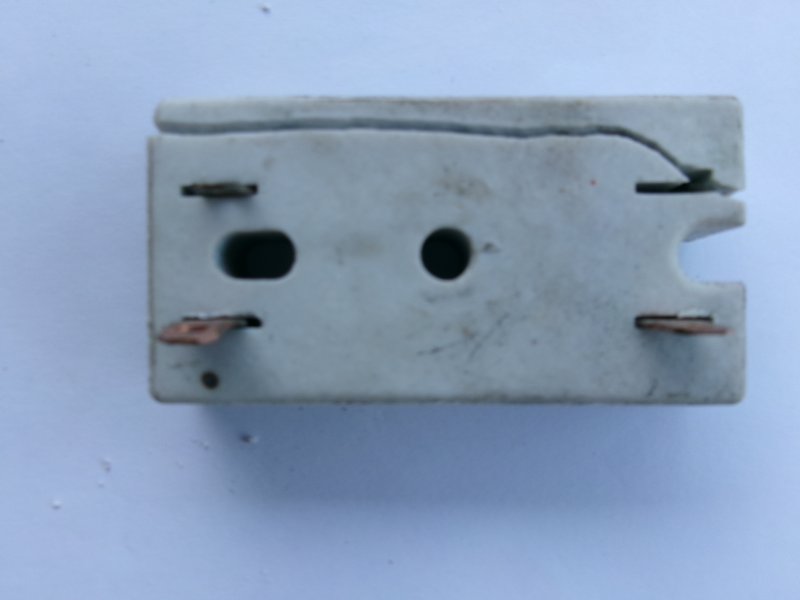

I took the 69 Charger out for a test drive today...I was about three miles from my house on the entrance ramp to Route 22 West when my car just died on me... I called my son and he came down with some tools etc. The car was not
getting any spark.... Couldn't find problem so we called for a rollback to take it to his shop (about 1mile away)... While waiting for the rollback I noticed that the ballast resistor was cracked (badly).... the rollback arrived and we got it to his shop
and we called the local parts store and he had one in stock ! What luck ! I removed the old one and the parts store delivered the new one in about 10 mins. I installed the new one and it fired right up on the first try and back on the road again. These
ballast resistors were a big problem back in the 60's, a lot of savvy people kept a spare in the glove-box, which is what I am going to do from now on.
That is a newer style dual ballast. Came out with electronic ignition in late 1972.
And subsequently, the two (2) prong resistor came out later replacing the origional four (4) prong unit and the ECM (Orange box) was redesigned to not require the origionl 4 prong resistor. IMO....aftermarket resistors can be open back or closed back, usually manufactured by DALE. it is my experience that the closed back resistor run significantly hotter and are more prone to failure. OEM type Mopar open back are better but cost more than the closed back design. Personally, I use the open back resistor, with the correct coil but with the Prestolite Dual point distributor, but if using an electronic ignition system, use the open back resistor that matches what ever coil you are using.......and .....keep a spare resistor in the glove box and maybe a spare ECM box as well......BTW, I've never had a resistor failure in the 37 years I've owned the car.......

I do carry a spare one but in over 50 years driving these cars I've only had one fail. In a pinch you can jump the terminals with a wire to get home.

you could have saved tow bill by jumping the ballast, it would have supplied full 12v to the coil, but for a short ride would have gotten you home
I was considering this but was unsure of how far I could safely go with a full 12V going to the coil.....
