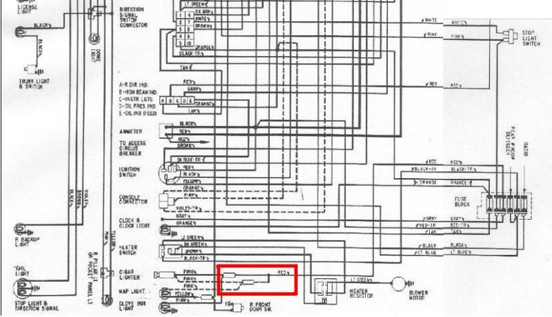

Under my dash (67 GTX) near fuse box are a number of wires. The single red wire (black boot on end) is not connected.
Any ideas on what this wire is and where it might connect to?
Thanks.
Check to see if it has constant 12 volt power. If so, I'll take a wild guess and say it's probably for a cigarette lighter. The gauge of the wire will determine it's use - maybe for an optional accessory.
About how large (gauge) is it, and is it solid red or striped, and what does the "boot" look like? Better yet, a photo?
If this is a cig lighter, it will have a right angle plug to fit a round stud connector
There is / might be a wyed off dupe that is for the map light setup
What 440roadrunner said.
