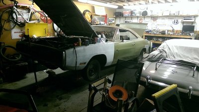

Having never disassembled a Mopar, I started cataloging and bagging and tagging the screws, clips, brackets with detailed notes as to how they went together and where. The reprint service manual was a useful guide. I should also say that every project - garage, house, car - is a chance to work with friends and family. Here's a buddy helping me take out the suspension and get it loaded up in the body cart:
Disassembly should move along nicely from this elevated height:

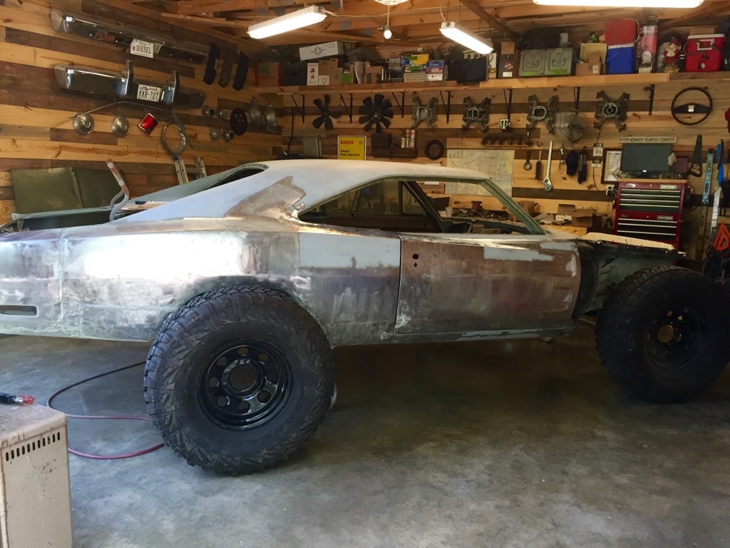

Got the passenger side glass out, and in the process learned why we don't see rear quarter windows anymore - what an intricate mechanical system.
Sanded the majority of the passenger quarter and door, leaving behind only the non-bodyfillered sections.
Also pulled the trunk lid and rear bumper and found more hack-job body work. The PO must have blasted or stitch welded without pausing, because there's a serious warp in the rear deck filler panel.
And our state fair is still a couple of months away, but the 3/4" bondo sculpture artistry on the rear valence corners was impressive. Blue ribbon.

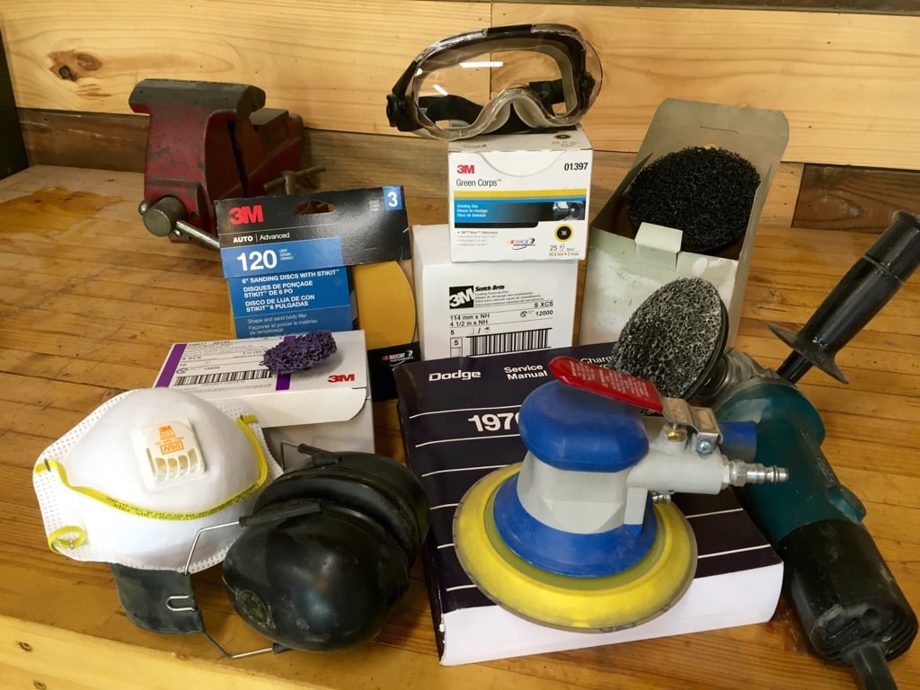

Quick note - I learned I was accidentally brand loyal. All 3M abrasive products:

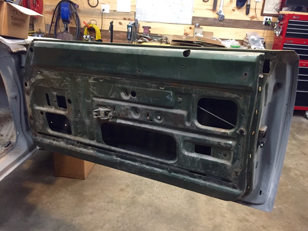

I did take a minute to organize; can't think straight if parts and tools are strewn about. Glass is packed and window mechanisms are carefully labeled and diagramed so I can put this back together a few years from now:

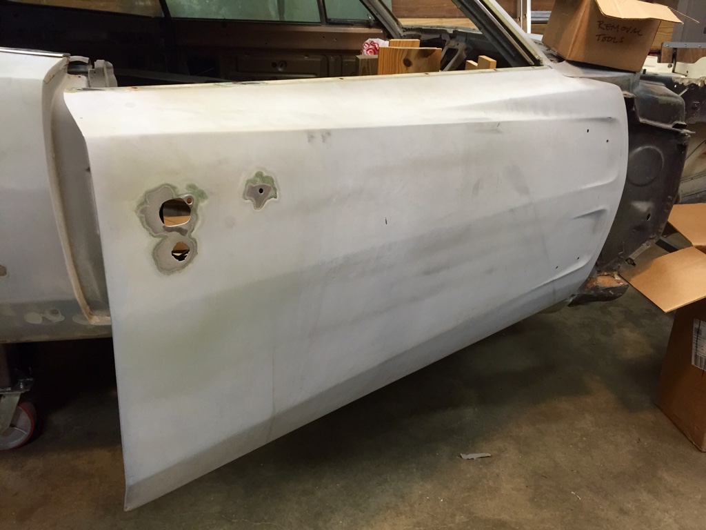

It doesn't look like much, but the door and trunk lid represent about 5 hours of continuous sanding with the 3M pads and 80 grit on the DA. For the hood, it's the first time the steel has seen light in 45 years:
Note the damage. I think someone slammed down a heavy box or something:
