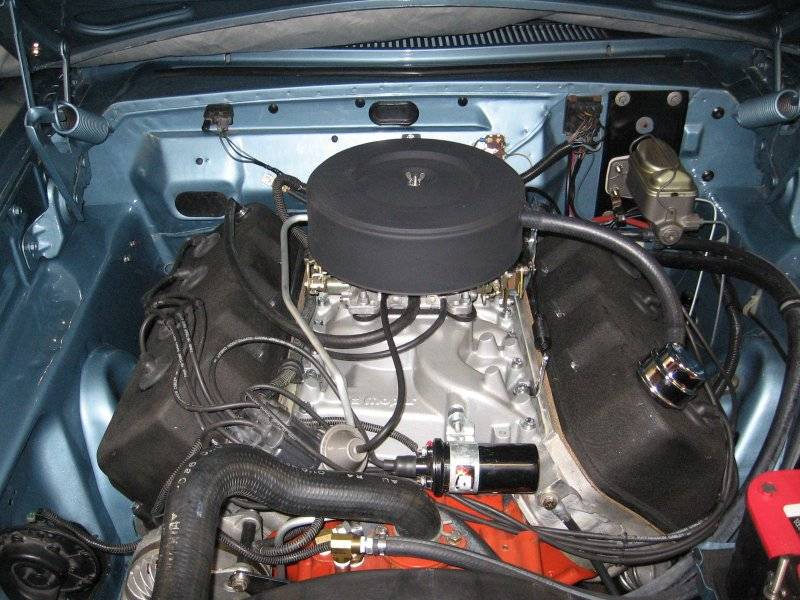

I know, quite boring but I was looking to save money. This was a cheap chrome lid and base that I sanded and painted satin black. I had several bases and lids in the shed so I just used what I had.

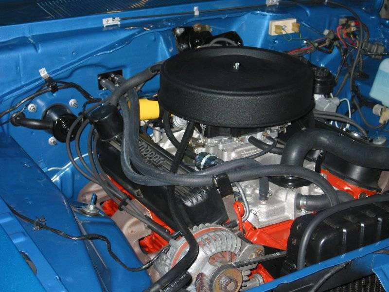

I ran the Mopar unsilenced on my Duster and 72 Charger with Thermoquads. Available from Mancini racing.
If your having air cleaner fitting issues, use a thicker or multiple gaskets under the air cleaner to add height where the ca b sits to help clear the top of the fuel bowls. The fuel bowls are not only a little high but have an odd contour to them that interferes with most air cleaners.

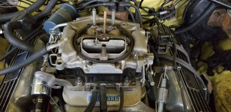

Here is my Thermoquad in all it's glory - I run it on my 73 with my stroker 340.

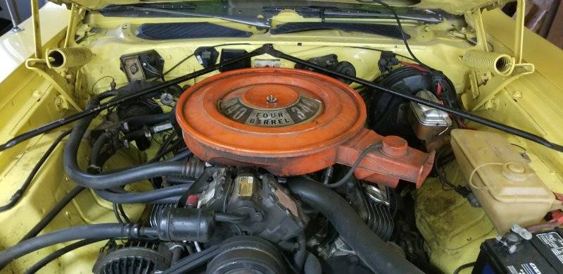

I run the original air cleaner (all dirty and skanky, but it is a near daily driver and drove across country)
I have in my "stash" a plain chrome air cleaner. It looks like this on the car (and fits fine):
If you want it, PM me and I will send it to you for free as long as the shipping isn't crazy expensive. You'll need a new filter (so I won't send that).
