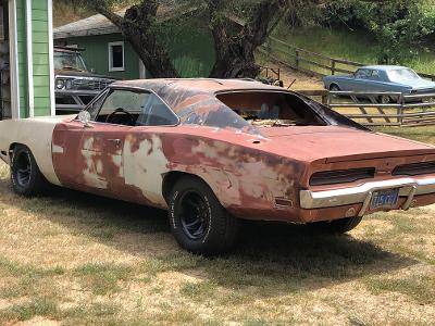

I had another one rebuilt a few months back. I may use it on THIS car:
