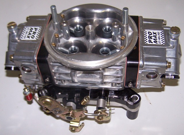

            I know I say it a lot but Promax's 850 custom built is $750, you call him and order it he will build it for your application, TO ME, that is worth a lot more than $750, and it is a hell of a carb. And even if you dont want to spend $750 he sells rebuilt Holley 750cfm carbs for $350!!! I have used a couple of each and NEVER had an issue... I had a 406 chevy engine with dart iron eagle heads, mild roller cam, but basically a 10-1 400 sbc bored 30, just a 450hp small block chevy... I tried a used holley I had on the shelf, it ran shitty, so I rebuilt it with what i thought would match the motor better, still not right, so I bought a brand new barry grant, NOPE, still ran like shit, the motor was sitting on a dyno, that someday the shop would want to use for a different engine, lol, so I called PM and asked if he could do something fast for me, $350 for a rebuilt holley, bolted it on and it ran perfect... A bit of tuning after it was in the car, maybe 10 minutes!!! and it was a monster... SO I was sold on them, give them a look you wont be sorry...
            [​IMG]

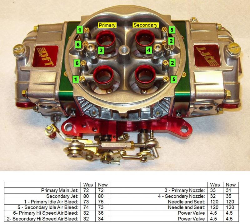

                Devin, if you get the quick fuel you will love the tuneability. Here is a log I use for mine.
                They are expensive but worth it.

                Thanks, that is why I want one.... tunability! I've done all I can with mine and feel it needs some air bleed tuning which it doesn't offer so instead of farting around I'll buy exactly what I need and be done with it.
