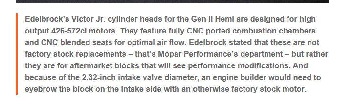

The install is an other issue because my bore is 4.28" they say 4.37" minimum. Is it as simple? as eyebrowing the block .090" at top of bore and .090 down? Any other warnings? Not sure I want to get into that, but what the hell.

Used a set on a 4.28 bore no problems with valve clearance. We were happy with the tolerance did have an issue with the after market rocker stands had to clearance something just don't remember where. Make sure you install the Orings in the head for the tubes before you assemble the rockers.
Last line in Piston to valve to valve to bore and piston to head clearance.
That states what they want you to have. It is not a bore limitation.

Snipped this from this website. From what @Polara426 said you don't need eyebrows, easy to check just in case. https://www.enginelabs.com/engine-t...ormance-with-edelbrock-gen-ii-426-hemi-heads/
I have a fairly mild cam I am sure if you are using something aggressive may be an issue but when building a Gen 2 you better check everything.
