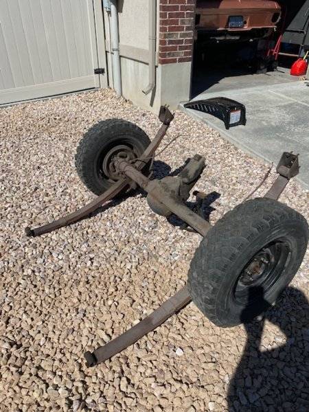

Driveshaft is already out. I was keeping the wheels on to roll the whole thing out once the leaf springs are disconnected, but if it makes it easier I can just pull it out on the jack and then put the wheels back on. The plan right now is new lowered leaf springs and new Dr. Diff axles with rear disc brakes. Also would like to change the rear gear ratio. It's 2.73 open gears right now. With it all out I can easily clean and repaint as well. Thanks for your reply! I am open for suggestions on the gears etc. if you have any ideas- car will be for cruising, no racing.
Well it took most of the day, but I got it out. No injuries either, so I'm pretty stoked. Thanks for all the help!
It would be good to use anti seize compound on all fasteners before reassembly, because down the road if u ever have a problem or want to make changes, it will go smooth as pie! Stay safe.
