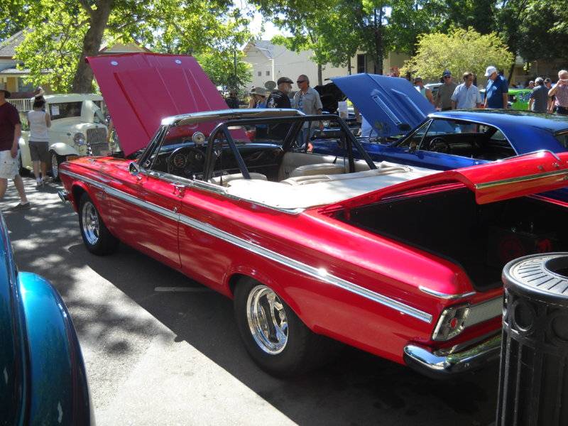

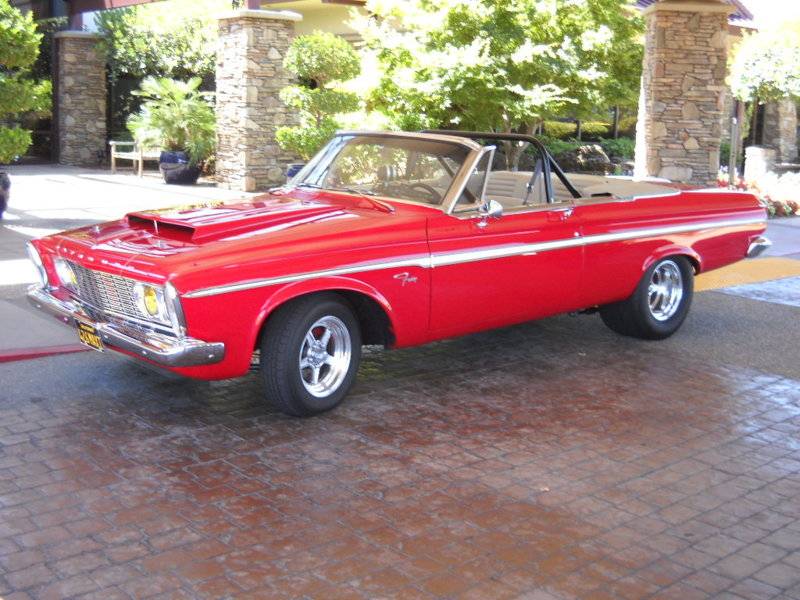

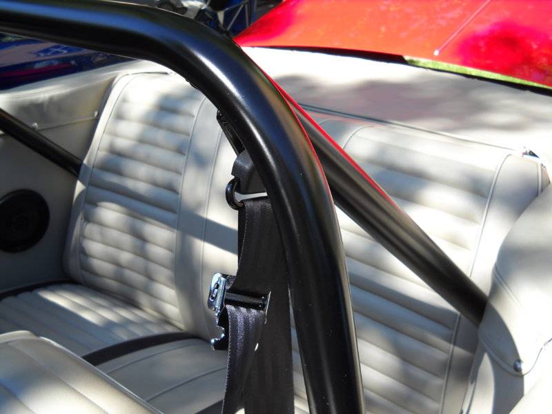

Looks great Dave. Like it belongs. Back seat passengers have something to hold on to.
Thanks, Dennis. Unfortunately, any back seat rider would have to be under 10 years old to be spry enough to climb over the crossbar (removable) behind the seats. Limited room for feet/legs as well since I moved the bench back 3"...
Back seat is easy access for full size adults in this A Body. Angle install is critical. Perfect for four with the top down.
