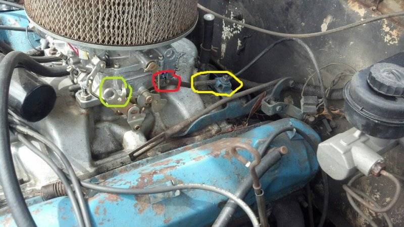

Not my car, but...
The red circle is the end of the throttle cable; it attaches to a pin I have installed in the green circle. That pulls the fitting too far from the clamp (yellow circle). Photo is a BB car; mine's an LA 360; but the brackets are the same.

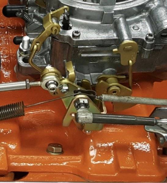

Just showing a picture where the adapter bracket for an Edelbrock goes and which location the end of the cable should be. This is a rear carb on a 2x4 setup but the throttle should be the same.
Pretty sure that's where I have it but I'll verify tonight. Thanks. What's the ball-end connector in the photo? Is that kickdown for that vehicle? Mine's the slot-over-pin style...
Early style kickdown with the ball. The slotted will have a pin there instead.
