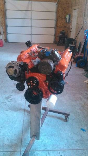

I am trying to find out the correct bracket/linkage for my 400. The satellite was originally a 2 Barrell I am going to be using an Edelbrock 750. Anybody have a picture they can share of the correct setup? Thanks in advance

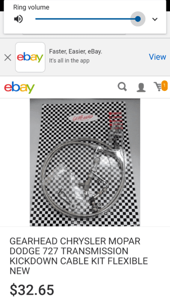

I think you can save yourself a whole lot of time, money, and trouble by just going with aftermarket throttle and kickdown brackets and cables. You can pay $$$ for the Lokar kits, or get the exact same kits as generics off ebay for about $40. These will let you get the throttle and kickdown connected regardless of what carb/intake you use.
Is this the kit that you are referring to?
