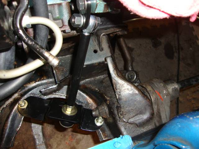

You should also have a limiter or some kind of a stop on your driver side motor mount. If it breaks and the engine comes up enough, it will pull your throttle cable and open the throttle while at the same time pushing your pedal back at you. Ask me how I know this lol. The only options if that happens is to turn the key off or go for neutral....or push in your clutch pedal.
Cranky
Do you have a picture of your fix in relation to the stop?
Depending on power, you can use a small cable from one of the block ears to the pad on the K frame. I've parted a couple of big Chryslers that came from the factory with them. If you're running plenty of power and have traction, use a bit larger cable. It's just a short cable with an eyelet at both ends and 1/8" diameter should be enough. You can also use a small diameter chain attached to a vacant threaded hole in the block.
Got it...a safety strap....
thanks
I doubt Justin will do that as he's trying to keep it OEM. But I have heard of guys putting a bolt through the drivers side oem motor mount as a precaution, to prevent separation.
Are we related, lol....you are correct my friend....
Oh I know. I was just doin a little :poke:
