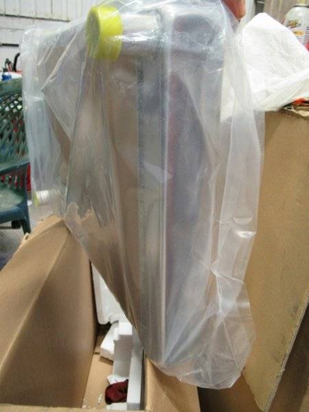

Here is another aftermarket one that I used in a customers car that is performing great. Car had A/C and was a stock 383. His original radiator did OK until he used the A/C.

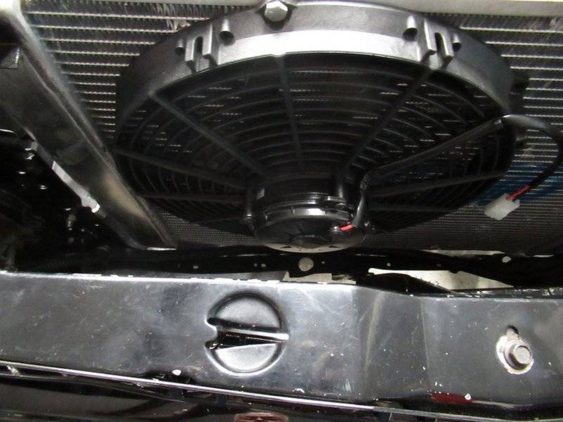

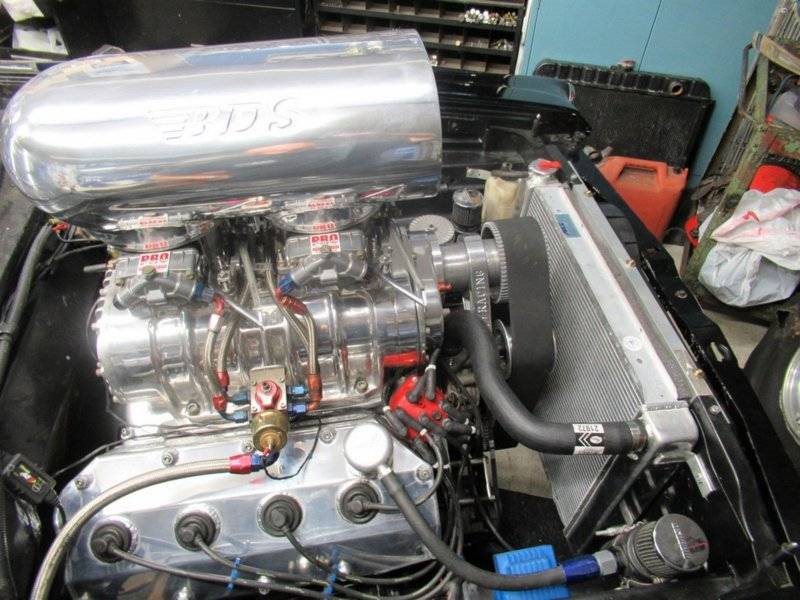

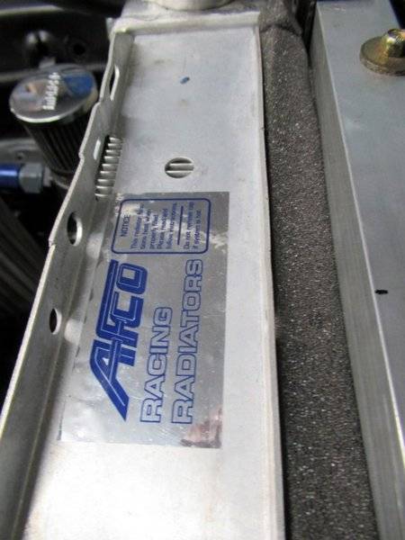

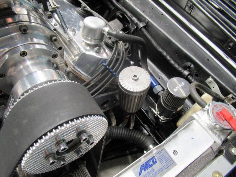

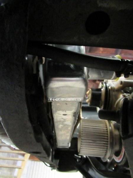

I have a $200 Afco aluminum triple flow that we tigged 4 aluminum "L" brackets to. For cooling it's a $135 Spal multispeed fan as a pusher as there is NO room for anything on the engine side.In the heat last week it stayed below 185*. At the track I go into the waterbox at 150/160* and cross the stripe at 180*. No shroud and hoodless.:blah::blah::blah:

That is the exact radiator I bought. You can get them black or unfinished. It is spot on for the original and mounts up to original holes in support. I believe my shroud bolted right to it without modifying. I love mine, no issues.
