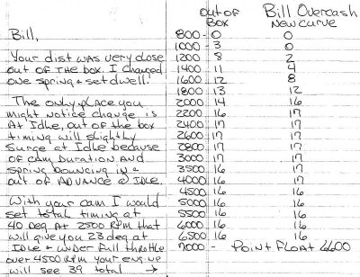

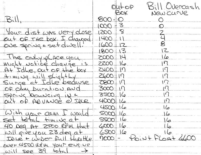

Lew,
Recurved dual point tach drive ,ported vacuum and runs like a clock.Distributor was done by Paul Petcou in Michigan,this is what he does for a living plus engine work for fast class racing.Attached are specs,cam characteristics also play a big part in timing,no two are the same. Distributor Curve.jpg62 Eng.jpg

Lew,
Recurved dual point tach drive ,ported vacuum and runs like a clock.Distributor was done by Paul Petcou in Michigan,this is what he does for a living plus engine work for fast class racing.Attached are specs,cam characteristics also play a big part in timing,no two are the same.View attachment 193101View attachment 193102

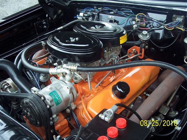

just got back from a test drive with a different combo using ported vacuum, (tried manifold vacuum and that didn't make out of the garage, lol!). i rtv'ed .055" spacer into the vacuum pod, (10 degree pod), to limit the travel. ended up with 48 degrees total at 15" of ported vacuum, (engine will cruise 20"). would like to have had 50-52 degrees but the thing just won't run with an aggressive centrifugal and vacuum advance. the new combo seemed work fairly good, will only need minor tweaking. i think the next step is to modifiy one these edelbrocks by moving the timed port up; looks like this is possible. straight manifold vacuum may work ok for low vacuum engines but i don't think it's the best on high vacuum engines. either has it's place but neither is "the" best for all combos.
