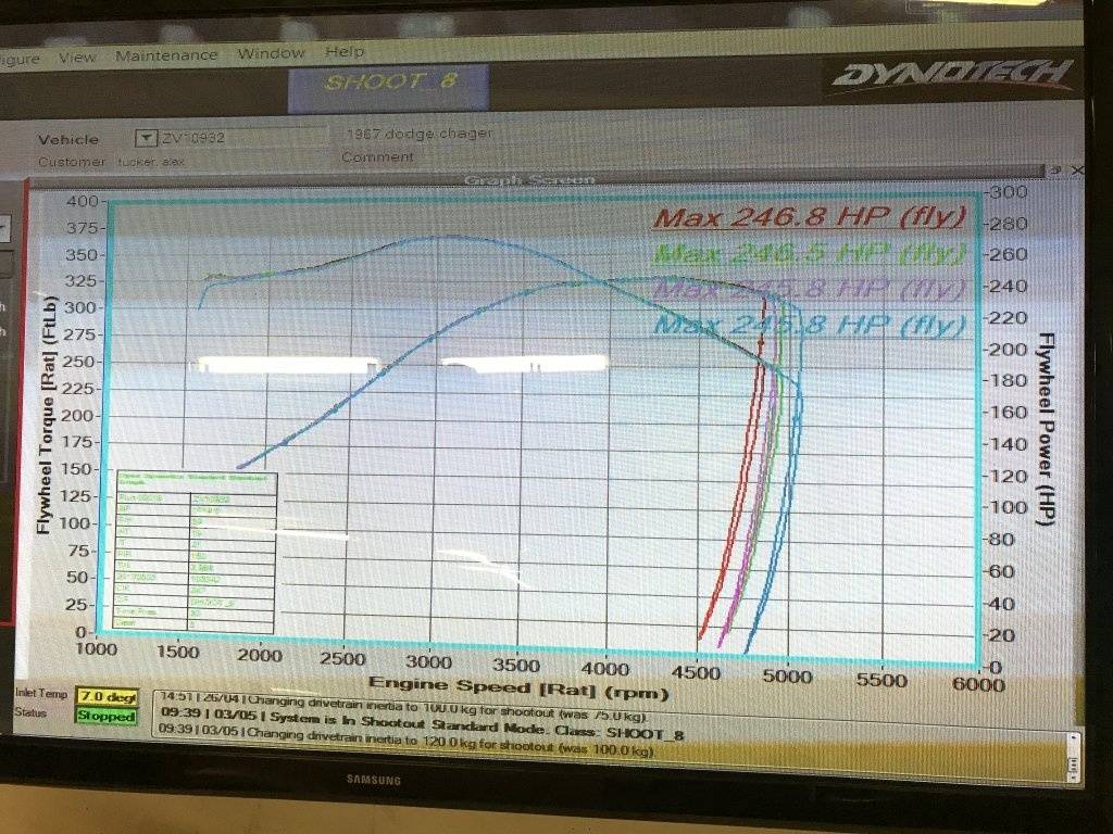

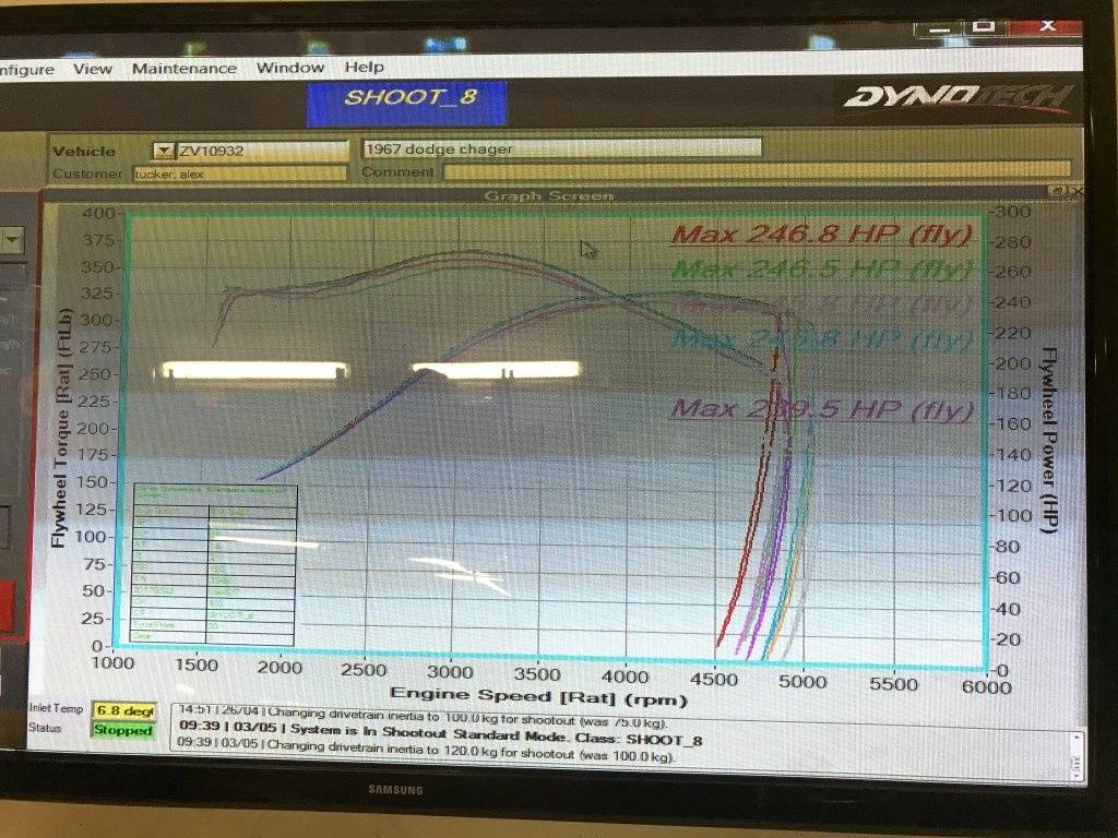

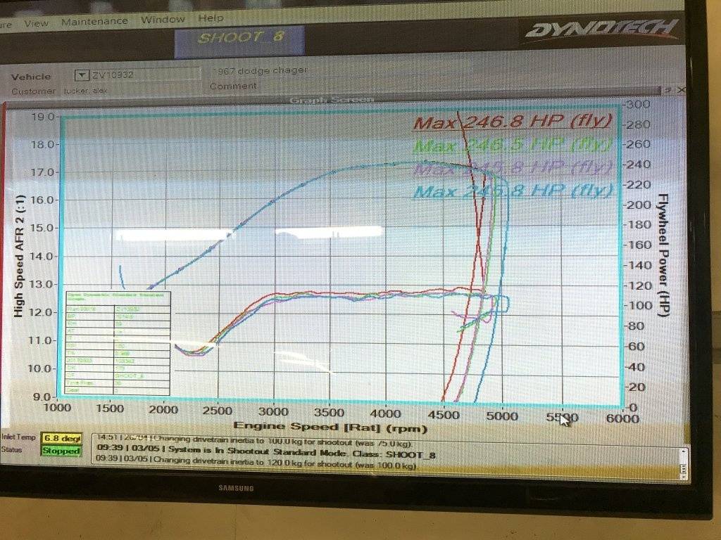

Here's my Dyno info would love your opinions as I feel the BHP is a bit low but I'm happy with the torc and it's very drivable with good fuel delivery.

what pistons were put in it; 8:1? a stock 383 4bbl (10:1 pistons) would only do 270-280hp.
All stock I think, I presume thats 270-280bhp at the flywheel? Mines not so bad then

What did you think of my Dyno results?
