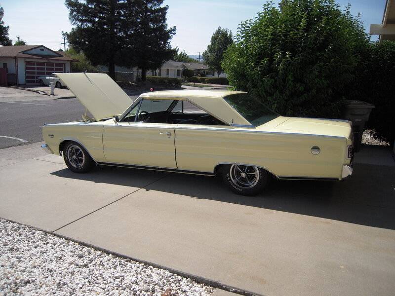

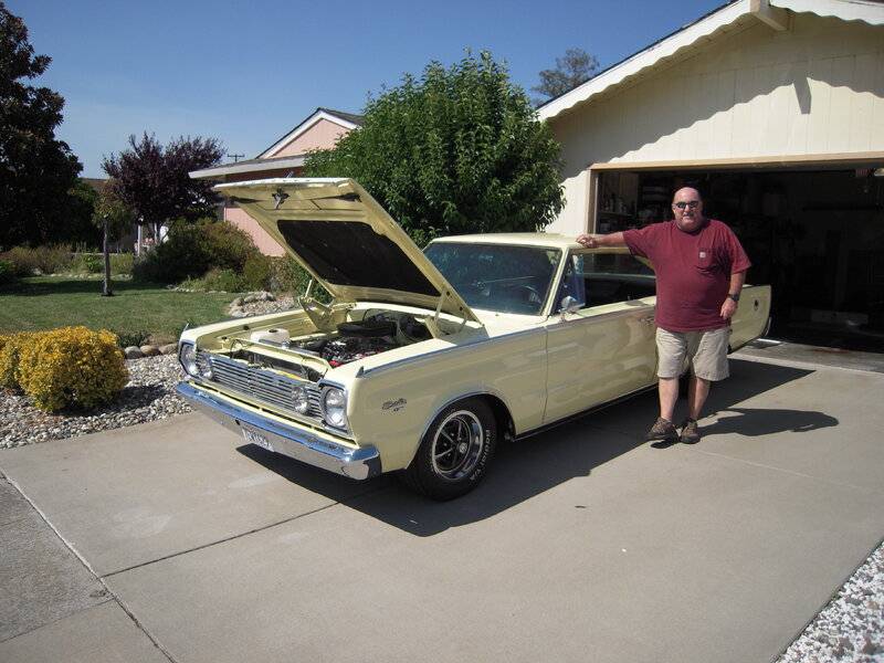

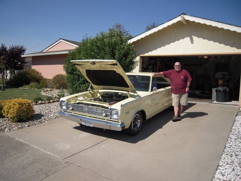

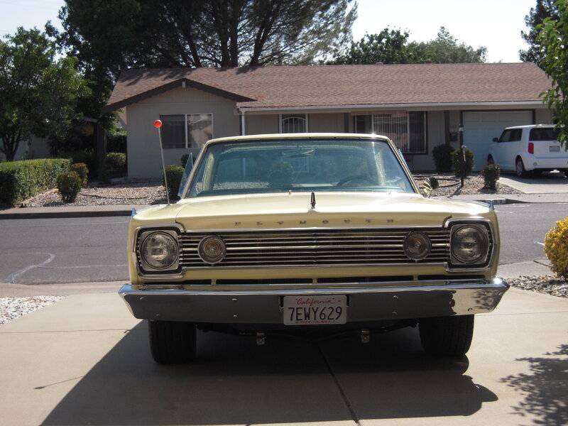

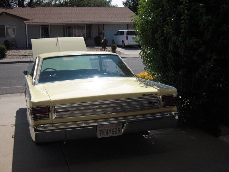

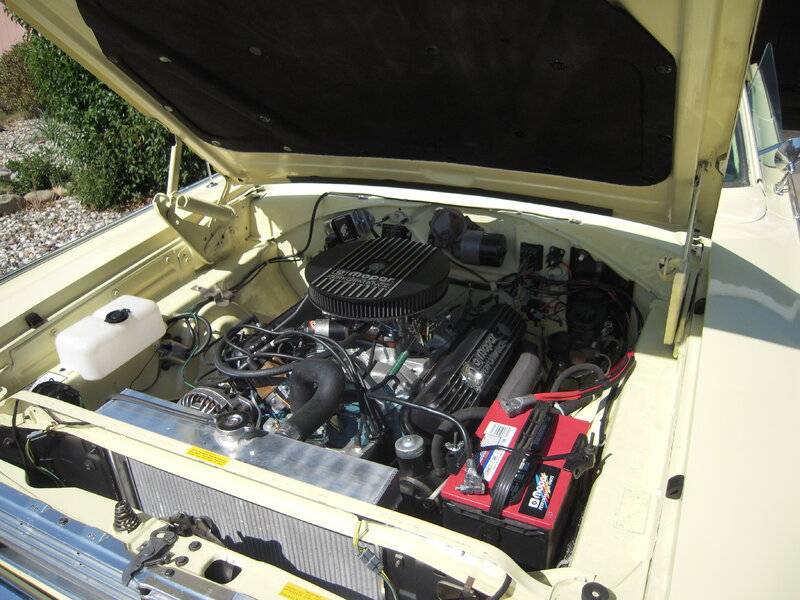

I have a 66 Ply Satellite. I lucked out in that it was a Western Car so it had zero rust. It did have some body work repair, dents and such but for the most part it was in very good condition. It was a roller when I got it as it originally had a 318 ci in it.. It had no motor, transmission, and drive shaft, a peg leg 2:76 gear ratio rear end. I had a 383 ci engine and 727 TF tranny that I put in in its place and found a correct drive shaft that only required an inspection for balance and some cleaning up and paint. I had the rear end re-built with 3:91 gears and a sure grip installed. I did the re-build of the rear end with all new seals and hardware, and fresh paint. The interior was completely gutted and then re-done by myself. In addition, all new wiring from the front fender turn signals to the dash was also done. I upgraded some of the electrical to bypass some areas and to make it more reliable electrical wise. I had it re-painted...believe it or not by MAACO...in the original yellow color. The hardest part was finding the chrome trim I needed on the belt line of the car. I lucked out in finding a NOS piece for the rt rear fender which was probably the last one in existence. The rest of the chrome was polished up and re-installed with new clips for the fender wells and the rocker panel. I re-badged it to show it as a 383 car. I found new chrome headlight bezels, a straight replacement grill and on the rear some NOS tail light lenses and buckets. Basically it took about 8 years to do and it still isn't finished. I still have to replace the heater core and swap out the door hinges for the NOS ones I have. There still is the little areas that I need to finish, but for the most part, it runs and drives like a scared Cat and is a blast to drive. I say all this because this is what you will have to do in order to find one currently. I periodically test the waters in the For Sale sections and on lin e to see if there is any interest. I just don't drive it as much any more and I have other projects that I need to attend to. You know...PRIORTIES!!! Here is a few pics for you to see what I went through with it. Good luck in your search...cr8crshr/Bill:thumbsup::thumbsup::thumbsup::usflag::usflag::usflag:
DSCN0288.JPG DSCN0289.JPG DSCN0290.JPG DSCN0291.JPG DSCN0292.JPG DSCN0293.JPG
Spend more and start with a nice solid car. Don't overpay for a 66. Many different parts between the 2 years, not a lot of crossover, even though they appear the same.
