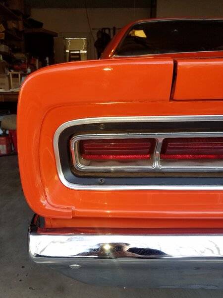

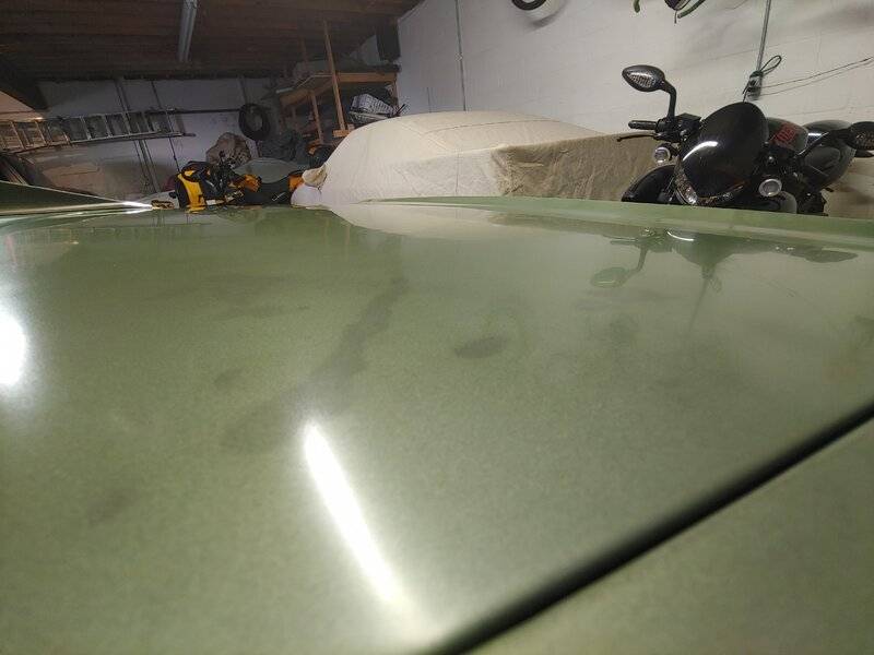

So, I've been having moderate success on my '70 Charger. It has an old, non-original paint job on it. It was a FL car all its life, and I suspect paint fade and/or a garage door incident on a quarter panel (and subsequent "we can't match it so we'll paint the whole thing") caused the car to be shot in a different light green than the factory F4. It's laquer, single-stage, no clear. Crackle-glaze, the whole nine yards. The rear is worse than the front (it must have had its *** pointed out of the carport or garage most of its life).
I've hand-wet-sanded the entire car. First with 1000 grit; then 1500; finally 3000 on an orbital, followed by polishing compound on an orbital, and hand-waxing. Looking across the finish, the shine appears nice and sharp, but looking at the finish the reflections are...blurry, is the best way to describe it. Like the surface isn't smooth/glossy, even though my fingers squeak when I slide them across it.
I'm thinking of getting another couple sets of sanding sponges and doing it all again...but I don't want to burn through.
I am NOT a body guy; this is the first time I've ever put sandpaper to a vehicle finish and I'm actually ecstatic that I haven't burned through to bare metal or primer yet! Does anyone (with actual bodywork experience LOL) have any ideas? I know it's hard to be specific without seeing the actual paint, and photos...well, they're difficult to get, and have show what I'm talking about.
In this photo, you can see what I mean by "looking across" the finish - it's nice and shiny and glossy from this angle in this light:
But if I look AT the paint, like standing by a front wheel and look at the hood, it's like I can see scratches and buff marks in it. Very odd. Almost like as if it was a clearcoat finish, and the color coat under the smooth clearcoat was what was scratched...

you've probably got it as good as it's ever going to look , laquer doesn't like temperature changes that's what causes a lot of the cracking , checking , you don't even want it under new paint , laquer primer included , it was used because it was cheap , just keep it waxed and enjoy your car the only alternative is to strip and repaint
Even with the questionable paint it is still a beautiful car. I live in Florida and the sun really does a number on old paint jobs.
Like Nevada dan says, keeping it waxed is the best you can do without a strip and repaint.
Judging by the photo it looks good enough for me!
It looks gorgeous in this picture ^^

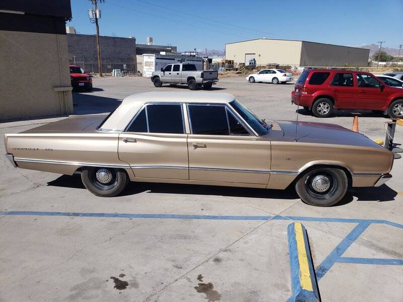

My '67 has the original paint, El Paso TX sun for 29 yrs, Las Vegas sun for 18 yrs and Fort Mohave AZ sun since 2014. Always garaged, but still driven to work n parked in the sun. They never had modern, glass looking paint jobs to begin with. Clay bar it n wax it n enjoy it.

A couple of my old bodywork/paint books from over forty years ago remark that old lacquer paint that shows checks or crazing can be helped by spraying a coat of straight lacquer thinner (slow dry) over the whole body to allow the paint to 'melt' back into a smooth surface.
As for the sub surface scratches, you could be right about your idea. Some of those paints had low hiding properties and were partially translucent, so if the primer under the colour wasn't properly smoothed and had some light sanding marks, they could show through beneath the surface as you described even though the outer surface is now polished smooth.

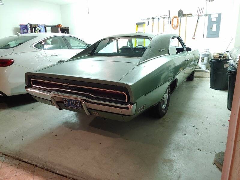

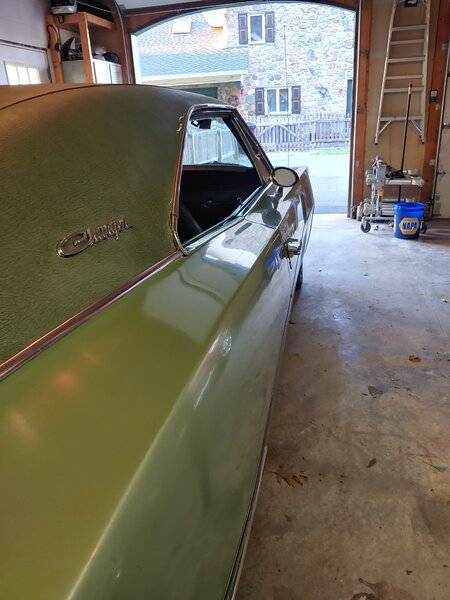

I tried to get some pics in the garage last night to illustrate.
Nice and glassy:
...especially if you look at the reflection of the motorcycle. (Yeah, the stains are in the paint...they're patina!) But, when you look down AT the paint, it gets blurry:
Quarter panel:
Trunk:
(and no, I haven't done anything at all to the dutchmen's panel at the base of the back window...it's on the list).
A good point above about the base being scratched/uneven. I don't know why the car was painted. I suspect living in Florida faded it...or, the one spot where my magnet doesn't stick (top of the driver rear wheel opening) rubbed against a garage door frame and when they repaired it and couldn't match the paint, they painted the whole car (the wrong shade). It looks like a $99 Earl Sheib job - no trim removed, most of the dirt wiped off before painting...but lord knows what kind of "prep" went into it.
I just hate to keep wet-sanding it, and end up burning through the top color is all.
I have thought about painting it. But, I like the originality - every panel is original, the paint is original-ish (my guesstimate is late 70s/early 80s), and it has a TON of patina. But...I hate the rub strips on the sides, and there's no way to get them off without painting. And if I get into stripping before paint...what will I find? How much will it snowball?
I just need to get over my OCD and live with it. I may take one more swipe at it with fresh sponges - wet 1000, wet 1500, wet 3000, then another round of compound and wax - and just be done with it.

The crazing does sound like lacquer but I wonder if you really have an old enamel paint job. Refinish enamel was bad about going dull and non-reflective with time and i never had any luck bringing back a deep, reflective shine to it. From an angle it would look smooth and glossy after compounding and polishing, but looking directly into it, it would look cloudy and dull. Usually lacquer, if it was originally of good quality, will shine back up and have good depth and reflection after buffing.
Yeah...who knows. I got a lot of paperwork with the car (original dealer order, original bill of sale, original loan paperwork, broadcast sheet, owners manual, some random receipts)...but nothing about the paint, and nothing about the vinyl top that was added at some point (fender tag and broadcast sheet show painted roof; "Charger" emblems are in the wrong location).
Oh well. I'll just get it as nice as I can, and keep socking away cash for an eventual repaint and a fresh top (I like the vinyl, and the contrast of roof against quarter panel really shows off the curvy hips!). Appreciate all the input!

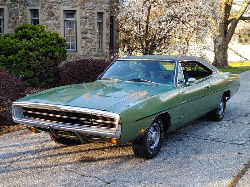

Well....someone posted a while back (maybe Kern?) where a buddy did some test polishing on their red car, with meguiars 110 and 210 compounds. I have been looking for those for a while...and tonight I found them!
The day I got the car:
And tonight. Final round of 1000 wet sand, 1500 wet sand, 3000 wet sand, meguiars 110, meguiars 210, and meguiars gold class wax:
Dutchmen panel, trunk, and passenger quarter panel top, are done. I'll work my way through the rest of the car this week and weekend.
I'm PSYCHED! That stuff is pure magic. Love it, thank you to everyone!!
