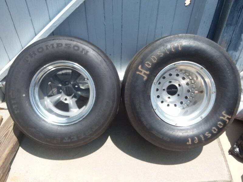

My 10.5Wx31 M/T's have been on 10" rims since day one. Last time out it went 1.261 60ft.
Doug
I run 10.5W's and 315's D.R.'s on 12" wheels. It definitely helps stretch the width.
