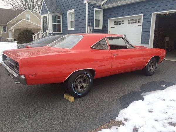

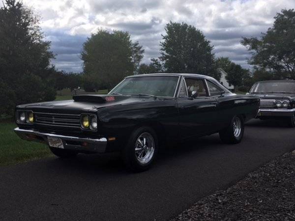

Make sure you get 4.5" to 4.75" backspacing. You should check before you order. Assuming the car is stock, the 15 x 8" wheels work great with 4.5" back-space and 275-60-15"s. This is a photo of my '69 with that combo. Buddy had a '70 and they fit the same on his car. If you need help measuring to be sure, shoot me a PM. Good luck and send pics when you're done!

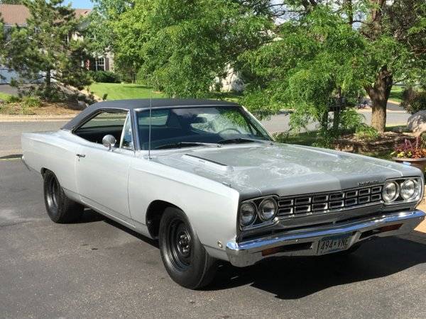

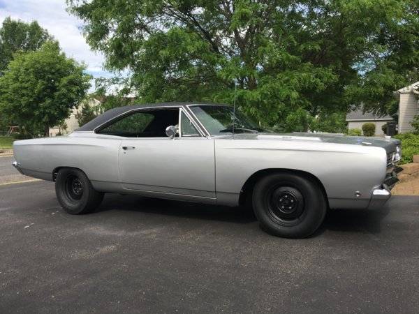

FWIW I have found great wheel tire combo IMO. 315/35/17s on the 5" backspacing 9" rears and 245/45/17s on the 8" fronts. Rallye wheels from Classic Industries and Toyo Proxes radials and Drag radials on the back.

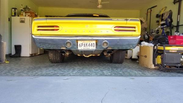

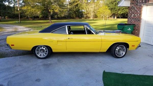

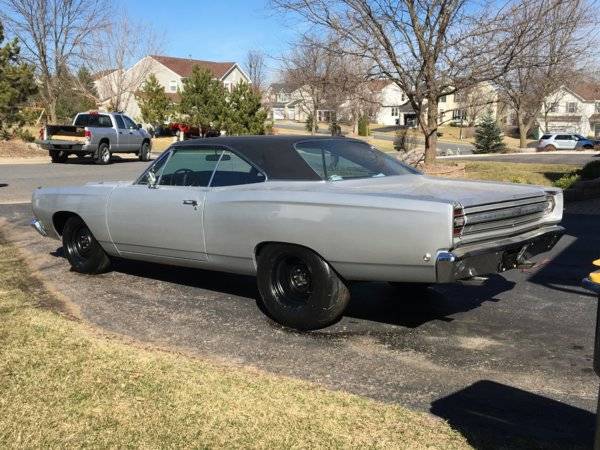

15x10s with 5.5 inch backspace would work as well, but in my car the 295 drag radials rub and I’m going to move the springs onboard and minitub with custom width Dana 60

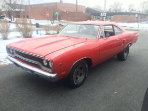

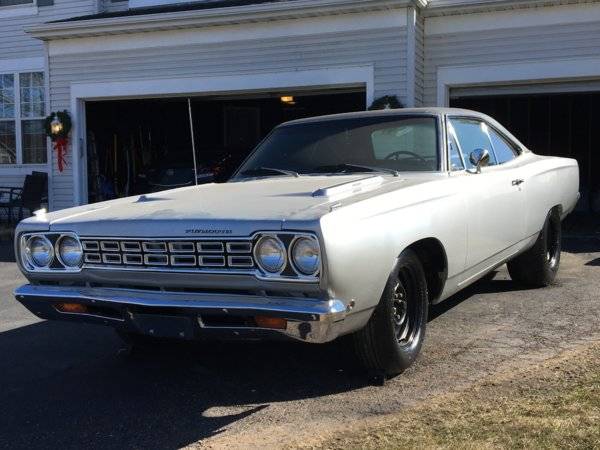

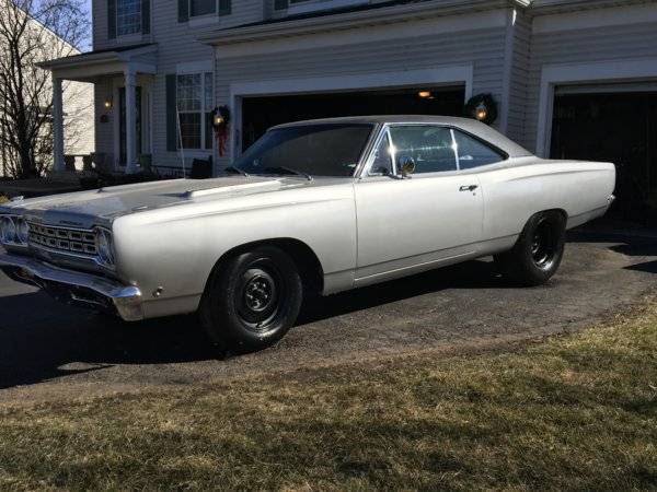

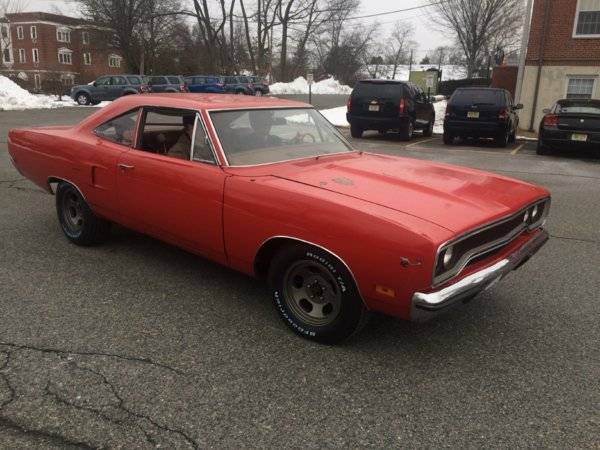

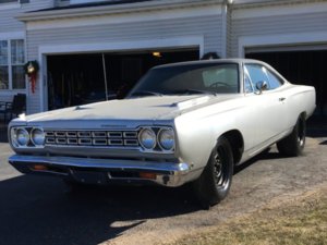

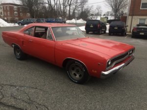

I decided on New Ansen Sprint wheels. 15x7 and 15x8. The 8" rears have 4.5" backspacing. They fit perfect. The front have 3.5" backspacing. Tires are BFG 225/70 and 255/70. I like the look. Real happy with them. Thanks for all the input and suggestions.
