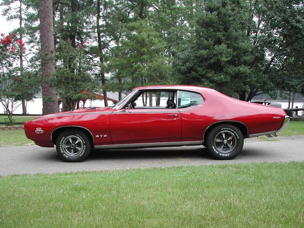

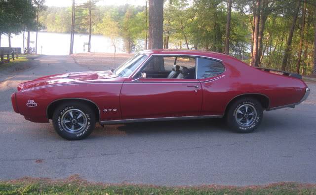

On a 69 GTO I had 14x6inch 225/70s all the way around.
I needed new tires
the car was fine as it was. except 225s a tad too wide when all is said and done for 6inchers.
I went to 275/60/15s in the rear.
again, the car is fine, except 275 a tad too wide for 15x7 when all is said and done.
