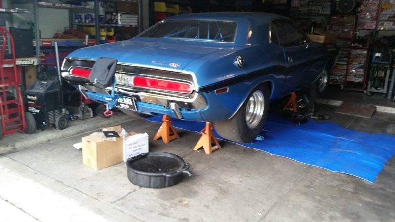

I know different body style but I have 315's on my Challenger. They are huge. I did move my springs inboard and the same will have to be done on a B Body. 295''s will fit with the perfect back space. I think it is 5".
Wow they really do look good on there. What size rims you have and do you know the section with with them inflated?
I have them on 12" rims. The section width is like 15-1/2" wide.
