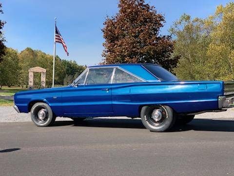

For my RS23V0A****** I'm using 275R60-15" on all corners with Mopar Rally wheels with out any clearance issues even at full right or left steering lock. The front ride height is at service high limit, rear suspension is standard Mopar 5 + 2 half leaves and 6 leaves left and NOS Monroe Super 500 shocks all around. I'm using a Dsna 60 @ 4.10: 1 ratio. Speedo is off by 3% at 60 MPH (~ 2900 RPM @ 60 MPH). For me, it looks just right....but this is just my opinion.
