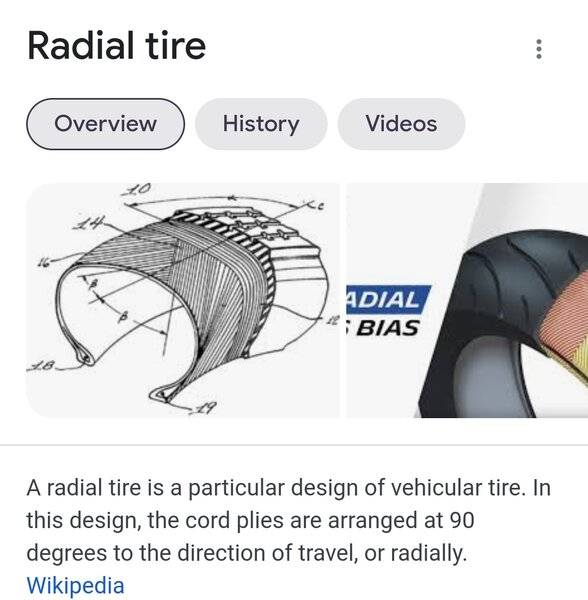

Then u better look up a tire rotation for a 4wd truck. There is absolutely no problem switching from side to side. What do u think radially means? Kim

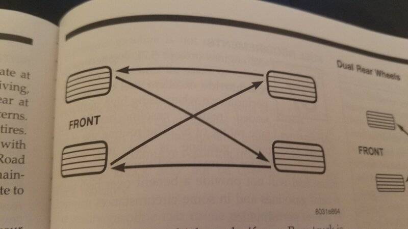

Not sure where everybody's 'hearing' not to rotate side-to-side from, the user manual for my '04 Dodge as well as the care sheet that came with the last set of tires for my wife's Ford Edge say otherwise...and they're definitely radials.
The only exception I read is, if you have all-season tires on the front and on/off road type on the rear ( or directionals of course) then don't switch sides. I stick with what the factory and tire shop recommend...good tires are too dang expensive these days.
I have two 4wd trucks and rotate the tires - I've not seen a need to swap tires side to side on my old car...rotate yes. If it's fine to do...well fine. Just not something that I've done.
Ummmm... Definitely Not what you think it means... but yes, radials can be switched side to side.
