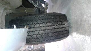

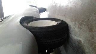

I just put L60-15 on a 8" rim with a 4.25" back space. With the wheel mounted on a 64 Dodge you can see how much clearance there is between tire and spring. To outer wheel well I have 1 inch maybe a little more of clearance. If I had to do it over I'd go for a 4.50" backspace.

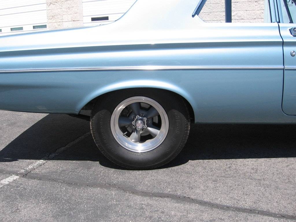

Here's 275/60/15 on 8" rims with 4.5" backspacing on my '64 Polara. Stock rear suspension and tapered axle diff. Plenty of clearance to the springs and fender wells.

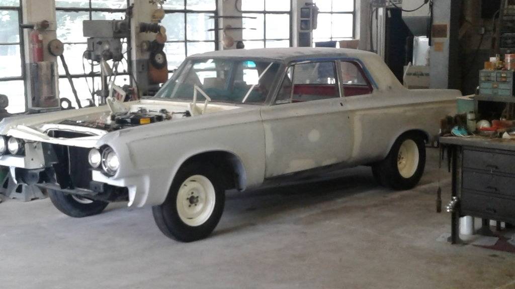

I went with Mickey Thompson 28/10/18 with factory 4.5 backspacing. they are a bit tight to the wheel well lip but not rubbing. I should've gone with 4.25 or 4" backspacing
