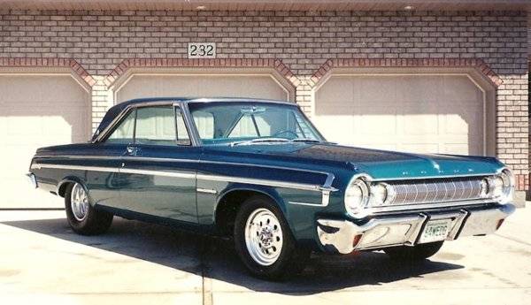

There's lots of room in the 64's. 275R60-15 no problem for the rear, that is likely what you'll end up with. The front will take a tall wide tire too.
An old pic of my 64 20 years ago. The rear tires were 285R70-15. They were a BF Goodrich sport truck radial. Fronts were 225R70-15 that I recall.
