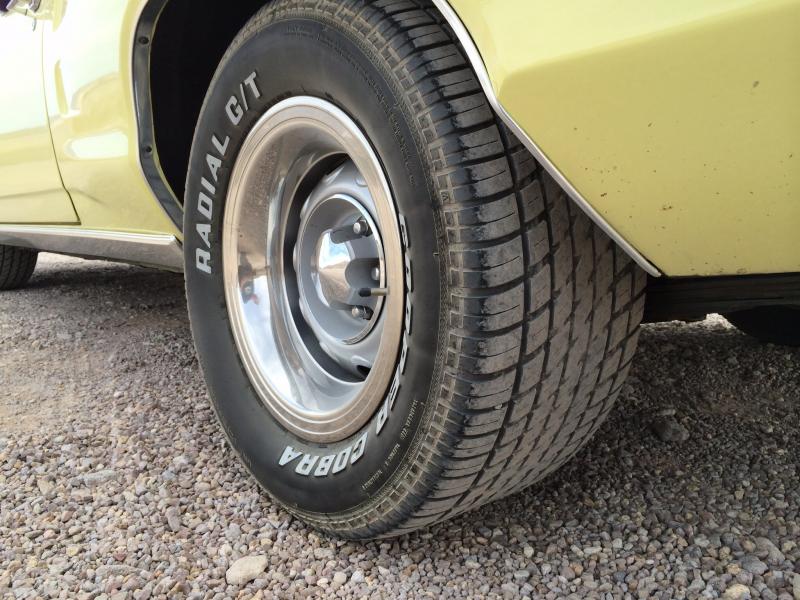

69 here. When making changes, offset etc was never considered. Bought 15x8 rims from Summit. 295's.
image.jpg If pushed hard enough in curves, there is very minor scrub agains the inside wall on the leafs. Could be ground, too infrequent to worry about.
