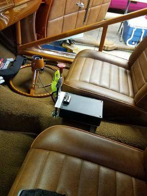

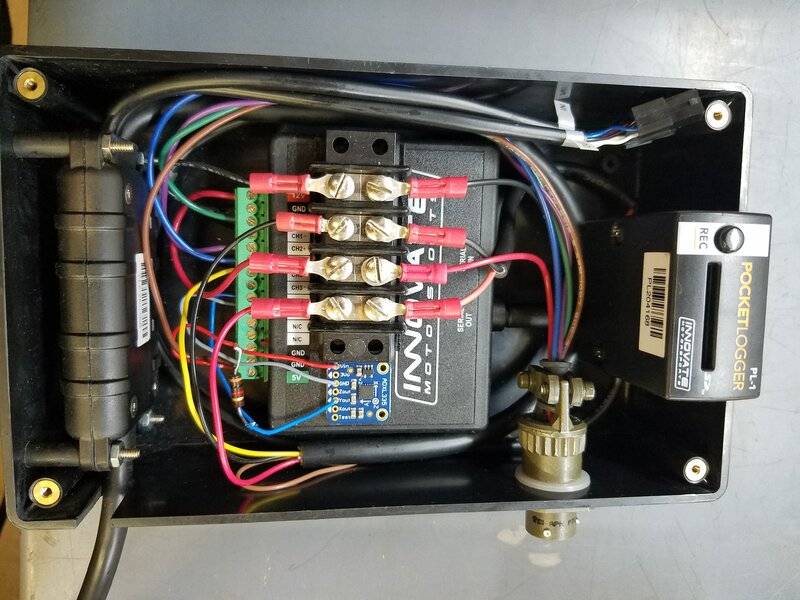

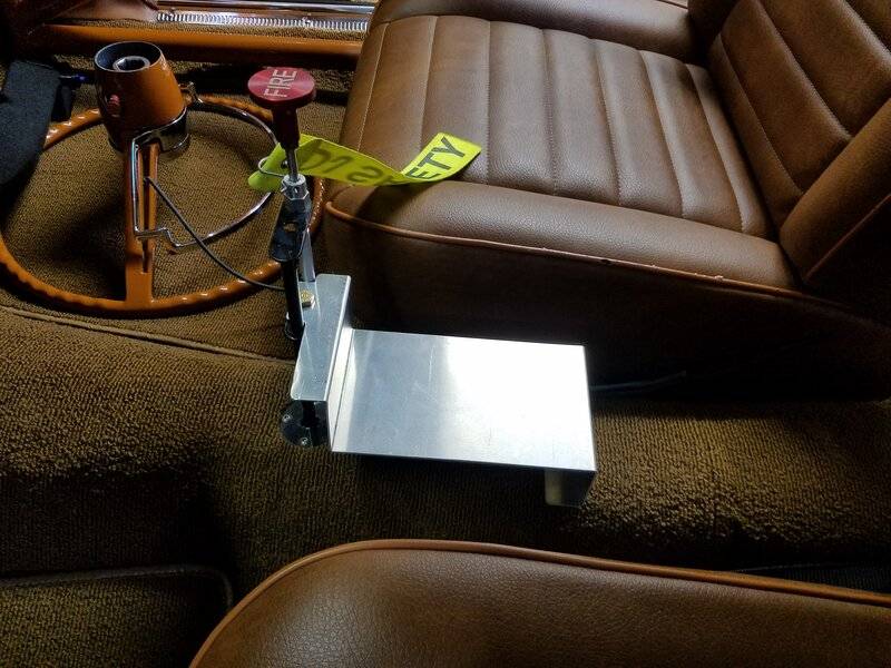

Its no Racepac but it'll record and graph accel G's, driveshaft and engine RPM, O2, and voltage. About $400 in parts. Since NMCA wont allow it the box is held to the bracket with Vecro. Hope to test next week.Doug
