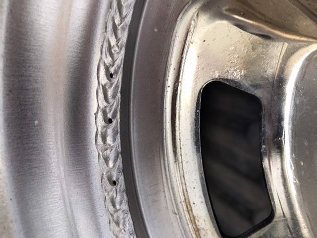

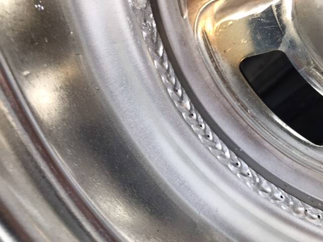

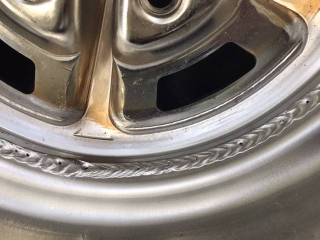

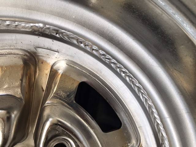

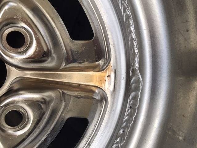

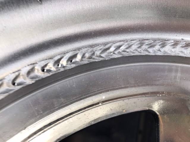

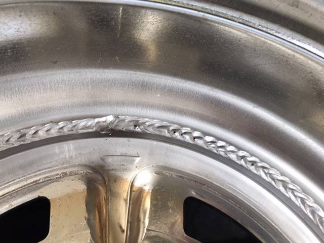

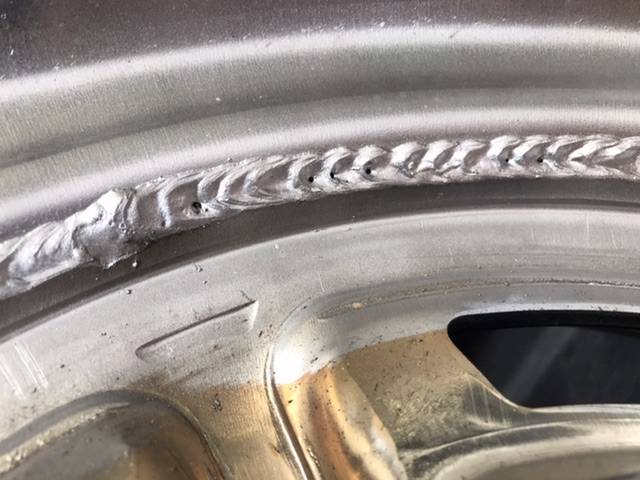

About wheels from Summit, recently decided to replace my magnum 500’s on my Gtx 67 with fresh ones , the replacements were of course made by Wheel Vintiques and were 15x7” as were my other set , the old set were pretty true running and the welds on back were very nice and uniform , no flaws , the replacements have the most ridiculous welds you could imagine! Totally unacceptable by able code anywhere! As an American Welding Society, Certified Welding Inspector these are borderline dangerous, and even though they have DOT cert numbers there is no way acceptable by any Highway Safety Regs! And neither want to make them good! Ck the pics

Probably not even a robot welder. Just some guy trying to lay down beads on a rotating jig, and doing it too fast to meet a quota.

I would have hard time believing that is a robotic weld , looks like gmaw, wire mig manual looking at starts and stops
