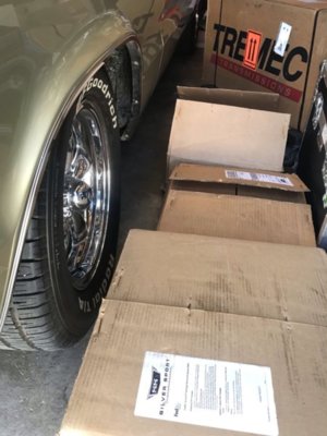

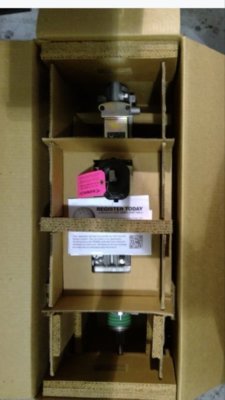

finally getting around to TKO 500 install
car: 1966 Coronet 500 - 727 auto/440cu with console shift
random pics for now
watermelon
DE5DDFC7-773B-4D70-AB59-3C50ACA7E472.jpeg F9385A15-8908-4015-8D34-197EF958C3E5.jpeg 0C5DA2BB-AA5F-44CF-B054-AA7625B70AD8.jpeg

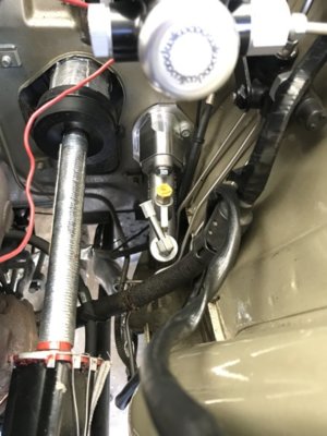

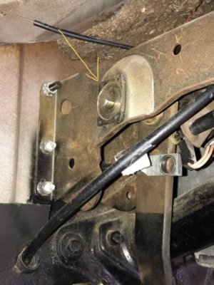

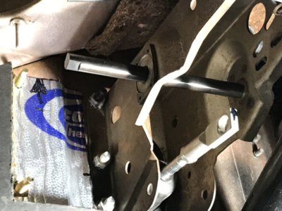

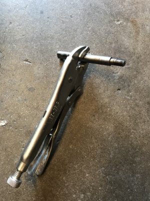

does this pin slide out?
trying to take off brake pedal. i might have to post this over on the 66 area.
thanks,
watermelon

Ok looks like if you take the nut off on the opposite end of that shaft it will slide out towards the parking brake. But I wonder why that shaft has that machined end with 2 flat spots. Could this be an attachment point for a clutch peddle?
I made a video but my Iphone is being a dick and wont let me upload it to youtube.
thanks for looking into this.

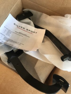

the sst kit did come with a new extended shaft that also has the flats. will find out soon.

got it out...a clamp to do initial compression...then vise grip to clamp...then hammer to tap on vise grip and caress it out
look Mom....no pedals!!!!

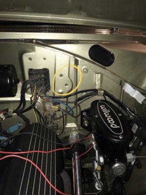

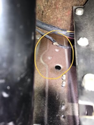

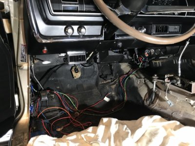

i need another firewall pass-through for some electrical
gonna use area in pic
i probably should relocate battery to trunk
