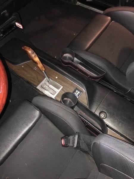

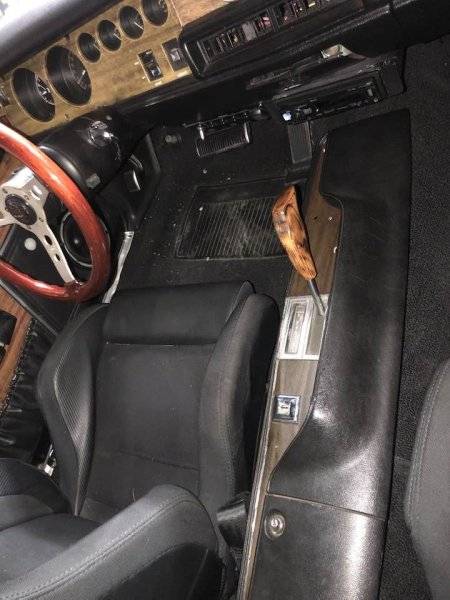

I have a 70 Charger 500 SE. It has a 70 E body center console (in it when I bought it). My question is about the difference in center consoles. Does anyone know about the shifter locations as I will be buying the complete 5 speed conversion from SST. Should I buy everything for the Charger or will this E body console make things difficult for me? Thanks in advance!

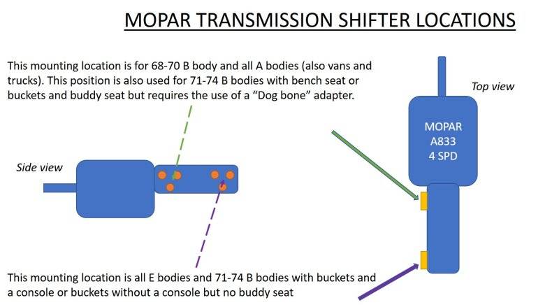

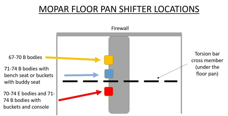

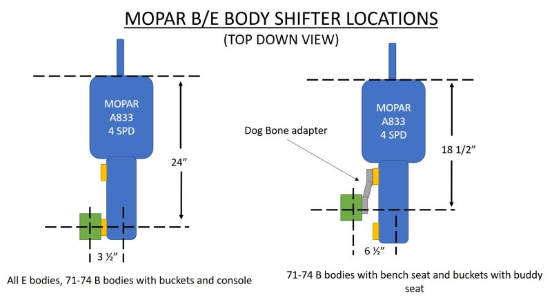

Perhaps some of these pictures will be helpful. I recently helped build a 70 RR with a TKX and we used the rear (E body) mounting location which put the shifter right at the front of the buckets (like you would think in an E or 71-74 B body).
The consoles are vastly different between a 70 B and E body but I would think this would be person preference.

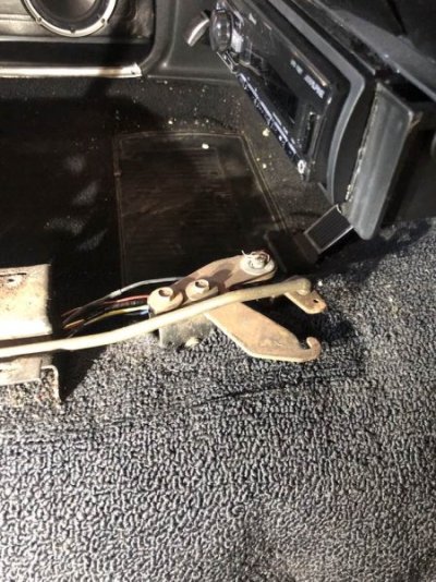

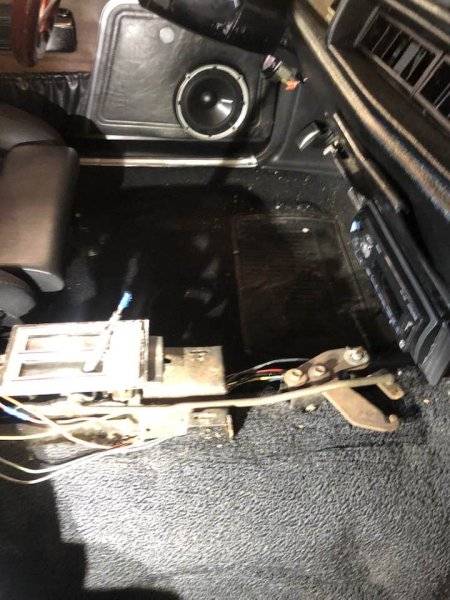

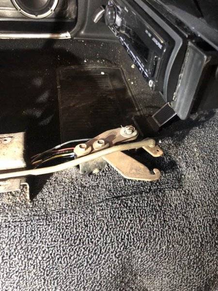

Nice. I have the 727 tho. Here are a couple pictures. I have to move the console and the carpet out of the way. i dont think anything was done to the tunnel. i think he just put in that console.464287325_10234268167436099_1988712349243460554_n.jpg464788901_10234268179596403_1128519854426541097_n.jpgshifter.jpg

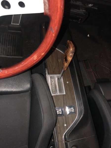

I just put some pictures up of the shifter. I am hoping that the shifter is in the original position with just a different center console.
Removed the E body console today. Now I know I have to either modify/fabricate this center console to accept the new TKX shifter or go into the market for a 70 Charger center console.

Don’t know anything about the tkx but years ago when I did my T-56 Magnum swap SST didn’t even know of anyone using a console with a T-56 because of the fabrication work that had to be done to the tunnel, They didn’t know if you could even get it to work and look correct. lol. They however did just came out with their own shifter. So I took the Automatic console(the one out of my 70 Charger) and a 4-speed top plate and the rest is history.

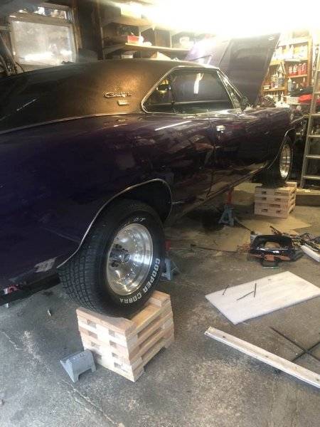

A quick update. I am unable to document the conversion as well as both Kern Dog and CoronetDarter so I am not even gonna try. Reading their complete thread on this process is a must. However, for those that are wondering, I am keeping track of my man hours to get a feel for what this would cost. So far I am into 10 hours. That is remove console, shifter, seats, carpet, brake pedal, driveshaft, linkage, cooler lines, and drain trans. I am doing this on wheel cribs so some of that time was bulding them and getting the Charger up on them.

Oh and I picked up a used 68 Charger center console from fleabay. Its an auto so I will have to do some mods but way better than trying to make that e body console work. Guess I will be selling that e body console and shifter.

Posting about your project is absolutely encouraged. There will always be some stuff that gets repeated but most of the time, stuff gets mentioned that prior threads never mentioned. You posted the man-hours you’ve spent. That is helpful because I don’t recall anyone else making notice if that. Every project is at least a little different from the last one. You’re doing this on a floor and not a car lift so you may come up with issues that offers will encounter.

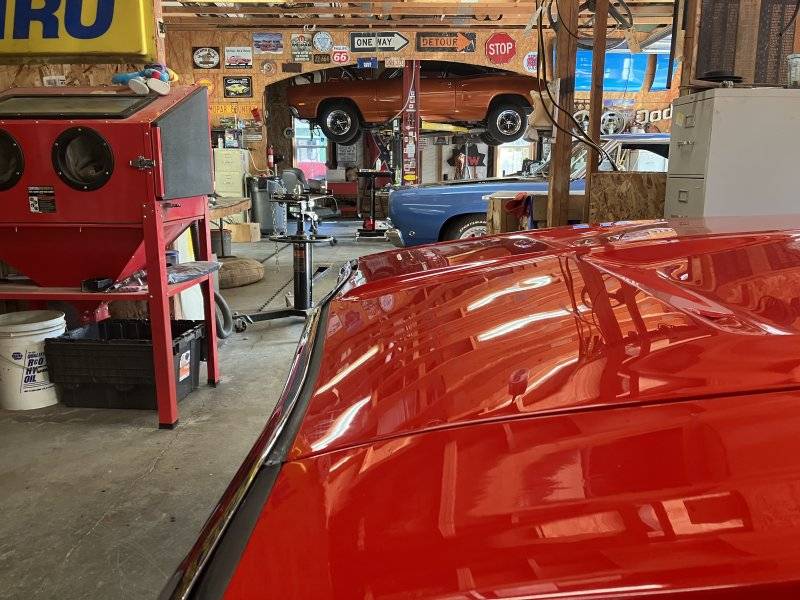

I have been trying to justify the installation of a lift - just cannot bring myself to do it. At work we have 12 hoists and 9 pits for 40' city buses. However, when I retire in four years and build the barndomidium all bets are off!
I built my shop out back in 2006 …
I framed the room on the right with a vaulted ceiling tall enough to clear a lift. I didn’t ended up buying the lift until 2015. I am still capable of flat back work but I won’t always be so lucky.
Your setup looks stable with those wooden stands.
