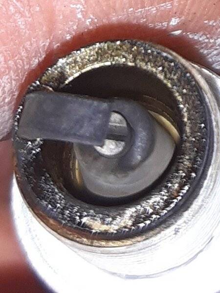

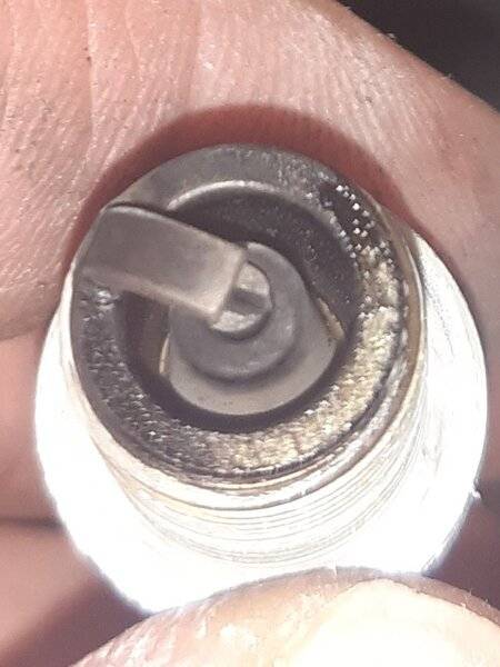

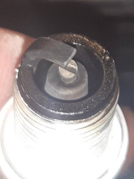

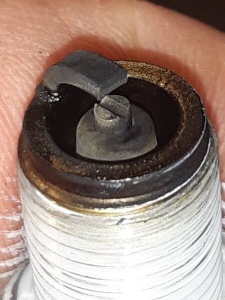

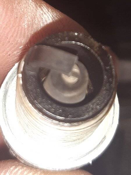

Hi! What can be said about these spark plugs, i think they are to cold and wrong for my engine, it is ngk 7 non projected tip. The engine 493 cui stroker scr 10,04:1, edelbrock e street 84cc heads, xe275hl (231/237@050) camshaft, the engine runs great but slight misses on idle, the engine have about 400 miles on it since cam break in.
Yes. Look at the threads, there should be coloring from heat on about the first three, and it looks like you only have coloring on the top one. No need to 'test' with all 8, I would put 6's on one side and 5's on the other, run it a while, then see which one gives you the best indication. Even though more soot collects from too cold a plug, it appears your idle is also way too rich...
AF meter will be the best way to check your mix brother, the rest is guessing...IMO
Thank you, i will try to go hotter on the plugs and lean out the idle

Out of curiosity, why are you using a non-projected nose plug? The NGK series with the "V" center electrode configuration is a great design which promotes good flame front development. A projected nose plug would allow a slightly hotter plug to resist low speed/RPM fouling yet prevent high speed/RPM overheating or preignition. The projected nose is "charge cooled" by the incoming fuel mix. NGK also uses copper type center electrodes which offer a much broader heat range. In addition, NGK offeres several different electrode alloys and configurations for good versatility. It also appears that your application needs 3/4" reach plugs. Autolite has many different styles and types to consider. Champion also offers several configurations to consider as well. Again, fuel ratios, cam shaft configurations and ignition advance characteristics affect plug coloring.

Thank you for your answer i just wanted to try the non projected plugs and see hows it go with it, i have understand they prevent detonation but also that they mostly are used in boost applications. I have not heard any pinging with the hotter ngk 6 projected tip i drive before this and not see any signs of it when i look at the tops of the pistons with a endoscope through the spark plug hole but i just wanted to try these non projected style out but i will switch back to ngk 6 projected tip again and see how they look after some driving, the engine does have smoother idle with them.
The hotter the plug the more they project into the cylinder.
Not necessarily.....it depends on the design. Usually hotter plugs have a longer insulator, but it grows longer inside the shell, up to the sealing land that the insulator is anchored to. The overall length of the center electrode is longer but inside the shell. Heat range is also a function of electrode diameter, insulator diameter and density and insulator length. NGK's web site shows, in cross section, spark plug internal construction parameters as well as complete reference to all alphanumeric reference information.
