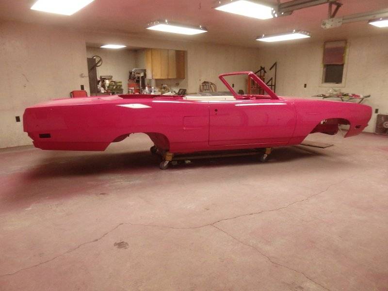

So my project car originally came with 14x6 standard wheels and wire wheel hubcaps. I have an NOS set of hubcaps and a set of correct w/w tires for it. I just need the rims. I have a full set of of Kelsey Hayes 14x5.5 rims I could use, just not sure if I should hold out for 14x6's. I don't see how anyone could really tell if I installed 5.5" instead of 6", but I am wondering if I need 6" for the front as it is a disc brake car.
thoughts?
