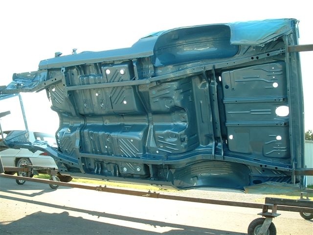

I second the Raptor Liner. I have the tintable to go on the underside of my Charger here shortly. I will be finishing the bodywork on the top side and then removing the finders to flip it on the rotisserie to do the liner before painting the rest. I will still be doing rubberized in the wheel wells and on the inside of the fenders as an added precaution/sound deadening. It will look really clean, be super durable, and allow me to drive it and enjoy it.
