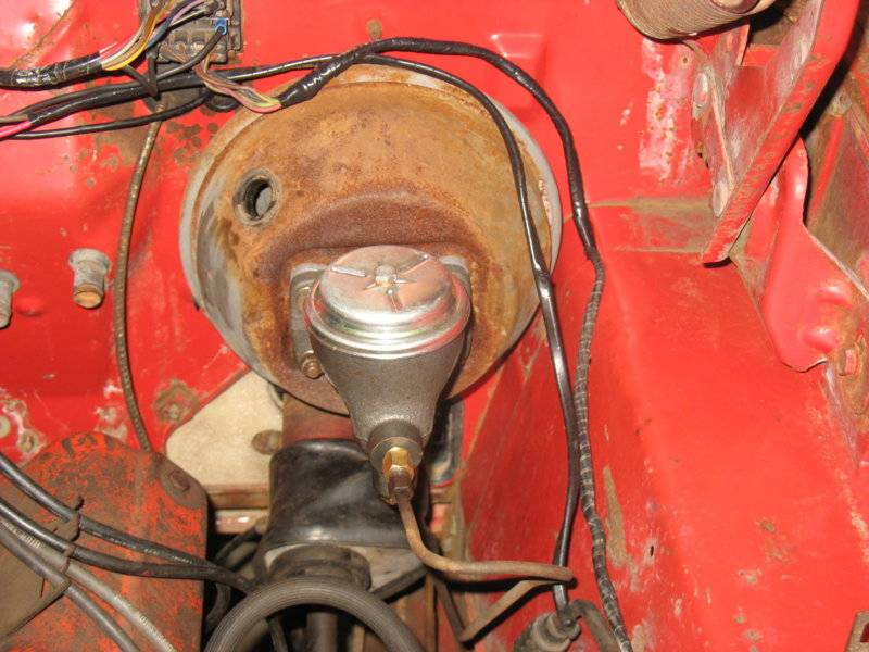

Here's my 65 PB booster. Getting ready to install the new check valve. I do not have much confidence in the results.

Interestingly enough, when I got the generic check valve at the Advanced Auto, they didn't have the right size vacuum hose, checked Napa and another auto parts in town and nobody had it. Ended up using some thick 3/8" hose and it seems to work fine!
The one at Advance was too small.
The one I got from Auto zone has an adapter to reduce to fit.
On my way out to put it on right now. be back in 20 or so.
No luck still the same.
Huge amount of vacuum.
I can remove the hose from the intake and it will stay stuck to my finger, there is that much vacuum, seems to be excessive.
