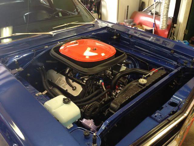

after a recent TF transplant (last week) i figured id see how it runs. i have some more to do, needs a line lock, drag shocks, probably take off the sway bar but for a first time out it ran pretty good for not really weight transferring. don't mind the reaction time, i wasn't really to worried about the tree tonight. this was with no burnout, 18 lbs in the drag radials, and driving it to the track. it did spin a little. figure once i get it dialed in i'll run it in sportsman once and a while

From your pic looks like you have a nasty machine. Love those cars that can't it all under the hood. Nice times for just kickin it! Would love to see another pic of the car. Looks like a beauty!
Details on car?
pretty basic short block, just has good heads
.040 over 440
KB flat tops .015 in the hole
LY rods
MP .557 cam in at 105
indy SR heads ported but standard port window
1.6 rockers
six pack
10 converter
4.10 gear
3in exhaust
full body & interior street car. everything works. need to weigh it but im sure its heavy.
