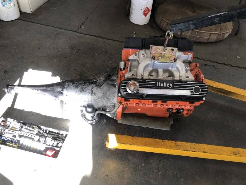

Last Summer at the Kern Dog shop.....

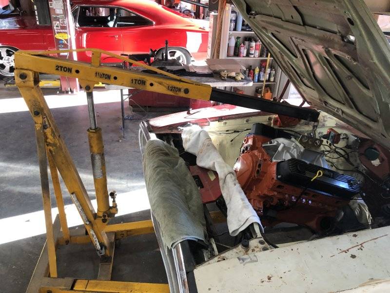

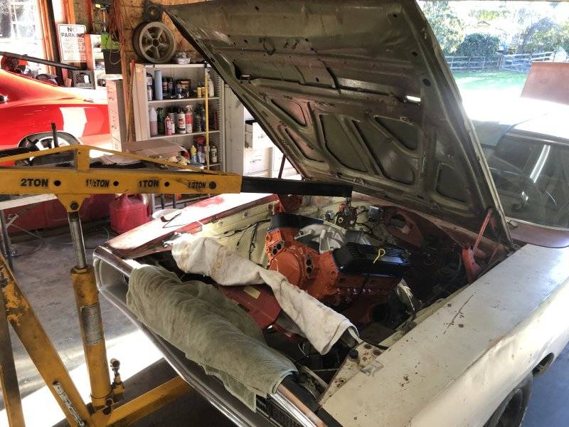

No problem......
