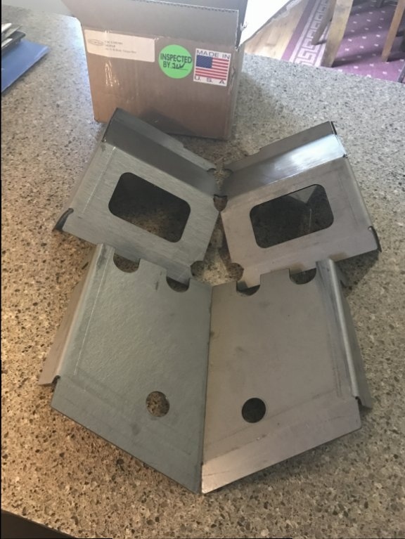

Hey guys quick question,
Got my torque boxes from us car tool today was wondering if I should wait until I have the driveline back in the car to install them or am I good to weld them in now? I know with the frame connectors you want to have the motor and trans in so I'm waiting on those
I put mine in with no drive train,along with the front rad support,you can buy this as a kit from us car tool n they always have a sale on depending on how much you spend.I ended up selling the frame connectors n inner fender supports to someone on here.
we installed them on a Coronet while it was on the rotisserie once. Putting the car on its side made it easy to weld them in.
